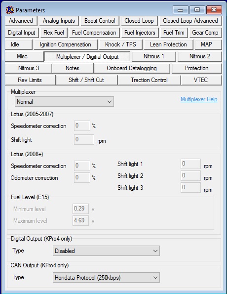

The Kpro4 supports CAN and the protocol is well documented on the hondata website and kpro help file. Below is a script that implements logging of most of the KPro CAN output. I left a few out that i don't need, but it is trivial to add to the script. You can upgrade your older Kpro to the new Kpro4 for $250, well worth it. This works like a champ!

Posts: 5956
Wow, this is fantastic! So many people have been waiting for Hondata support; we'll get this in our wiki ASAP!
thank you for your help bringing this to life.
