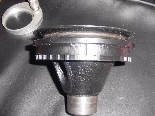

I for some reason just stumbled on this post. If you are still working on getting it sorted give me a shout. Going to a cam trigger with 72-2 really is not any more complicated than using a 36-1 on the crank. The reason for the sensor from an RX7 is two fold.
1. Size of the trigger wheel teeth. It can can sense smaller teeth. The teeth in the RX7 distributor are really small. I also remember some one using a piece of rod stock that had the 72 teeth in it that they cut to length and used in a distributor with an RX7 sensor (what got me thinking to use that sensor). The diameter of that wheel was probably about half the size of mine and it seemed to work well.
2. It works well with smaller diameter trigger wheels. If you read forward in my post noted above you will see that I had to take the sensor apart and assemble it to allow for a the bigger gear I was using. This lends it to being used inside distributors (where it came from in an rx7)
Lastly don't get all wrapped up in argument that you loose precision by going to a cam or distributor triggered system. Yes using the distributor will probably be the least accurate depending on how it is turned. My car has the distributor as part of the camshaft so the only chance of inaccuracy is caused by variances in the timing belt. If you use say a small block Chevy there crank turns a chain that turns the cam that then turns the distributor via a gear at the other end of the cam you will have a less precise system than had you just triggered from the crank. But ultimately it really should not matter especially for a street vehicle. Another thing to consider is that the inaccuracy or variances will be constant so you can tune for it. You can not do hat with the stock set ups.
What does all this mean? Not much really. For the most part but upgrading to an EDIS system is a huge improvement from the system that you are replacing. Voltage, reliability, multi spark at low rpm, and accuracy and reliability will all be improved not to mention that it gives you complete control of timing. So even if you retrofit the trigger to the stock distributor you will have an big improvement. Just make sure that all the bearings and gears are in good working order.
