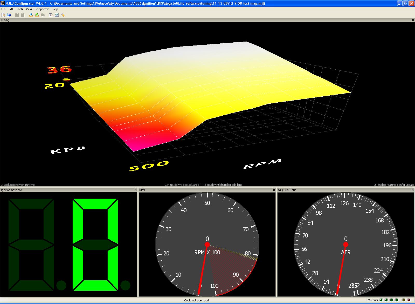

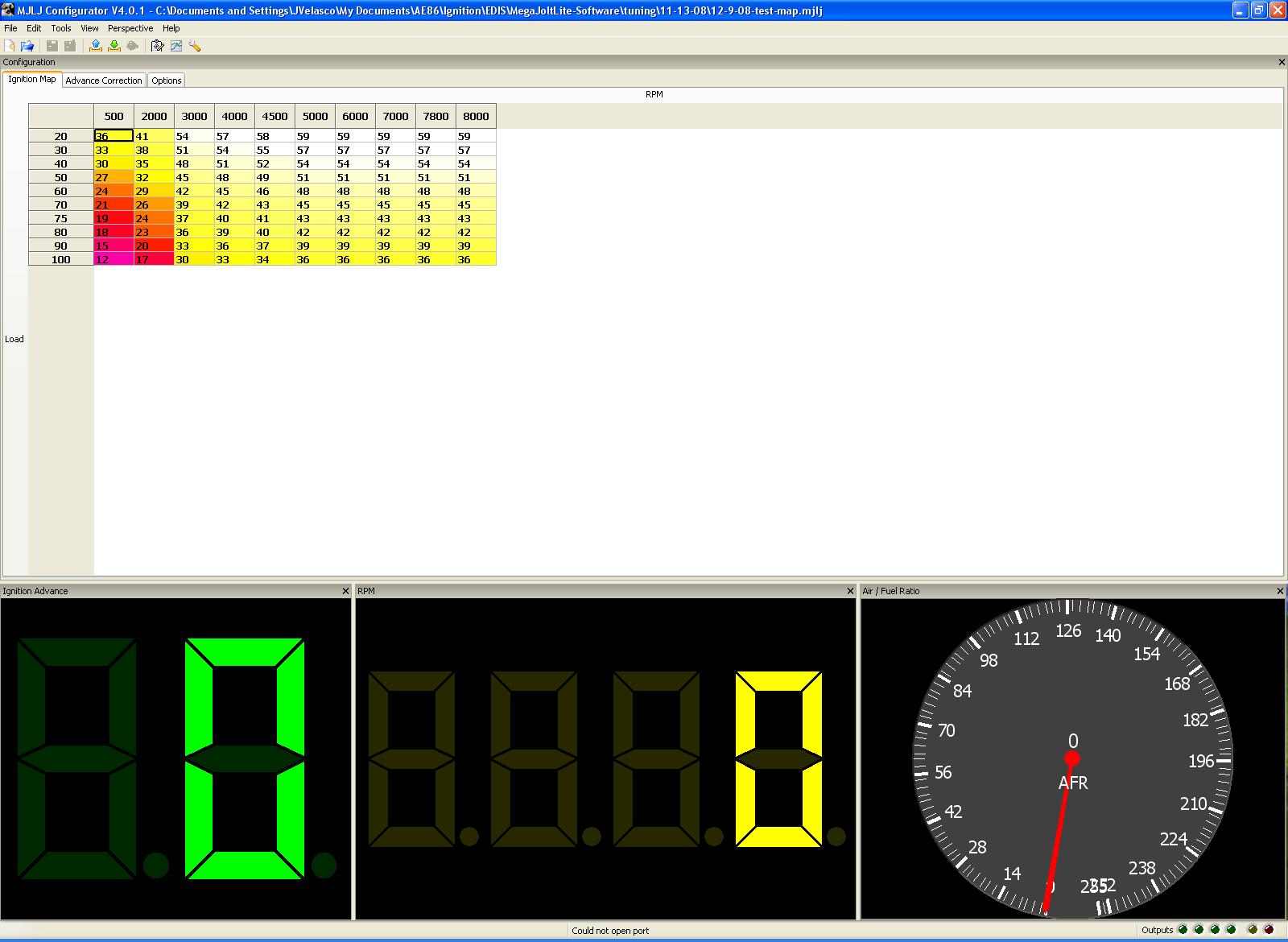

i visited the original thread Alex and i applied the suggested math to an ignition table that i've been testing with and came up with the following. honestly, i'm a little nervous now. :shock:

i have not yet even had a good look at the stuff i posted, as it happens, but it is good to see someone is giving it a good going over.
interesting point about the map you have come up with: there is a significant difference in advance between max and min load, for any given rpm ie up around 20deg. i have noticed, on a preliminary browse through maps which have been previously posted, that they usually have very little such difference. the little i have seen elsewhere on the Net seems to show that typical configurations have at least 10deg difference. somewhere in amongst all that is an issue well worthy of investigation.
