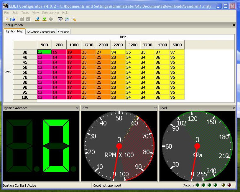

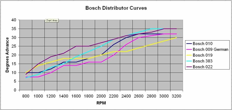

Below are my current ignition and the stock curve, right now it doesn't change any between load and no load. I originally had it with less advance under load then increased it trying to resolve the issue. Like I said it works fine at 2000+ RPM.
The coil pack and wires are from ebay, they were out of a junked car and reported to have been tested and working. The coil seems pretty strong as I accidentally unplugged one of the wires and the spark jumped about 4 inches to my hand. The motor stayed running during that which was pretty amusing. Just installed 4 new plugs, originally it didn't have R plugs in it, which I switched them out with. It didn't make any change at all.
The load is calculated through the MAP sensor
- Distributor curve
- distributor_curves.jpg (60.24 KiB) Viewed 11823 times
- Here what I have right now
- curve.JPG (125.76 KiB) Viewed 11823 times

Your load axis looks acceptable.
I don't think its a megajolt or edis problem. More than likely coil pack or leads since you have relatively new plugs. You can't really test the leads and coil packs with a traditional multimeter as this doesn't put a load on to these components so is not really an adequate test. Ideally these components are better off bought new in order to have a reliable setup.
What i would do now is a confidence check that the edis and megajolt are working correctly by using a timing light and observing the timing is moving as to what is displayed on the configurator screen above the 2000rpm where the problem is least noticable.

Those curves look good, but I wouldn't use more than 32 degrees from 70% to Full load above 3000 rpm. They really can't handle that much at full load, AFAIK.
