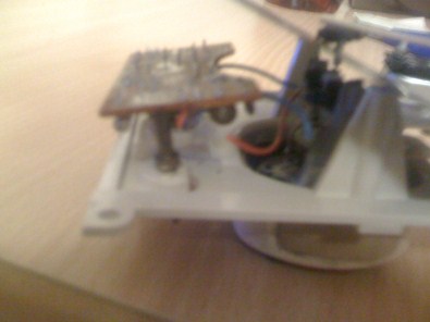

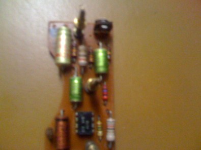

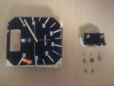

So first of all I disassembled the tacho to get to the tacho driver board (first 2 pictures). The tacho driver board (3rd picture) uses a SAK215 chip to control the rev counter, which is basically a current meter. After a bit of research I found the chip which is used http://www.datasheetarchive.com/SAK215-datasheet.html
