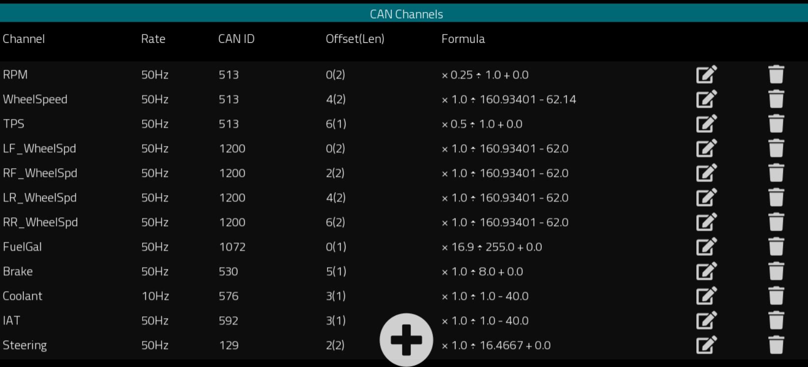

Series 2, if it has DSC,
Steering Angle
ID 129
Offset 2
Length 2
Signed
Big Endian

Pay attention to the Steering math, It is important if you want the steering to reflect the actual steer angle at the tire. Ill add fuel delta next as thats the difference between the left and right fuel tanks.
