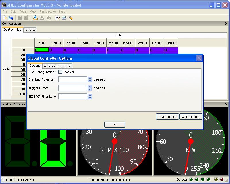

Just tried Beta V3.3.0 on an LPG Rover V8. Cannot find where to set 8 cylenders in the configurator which means I am getting twice the RPM I should. Am I missing somthing??
I am also using one of the outputs to cut the gas if the engine stalls (less than the minimum settable 500RPM). Occasionaly this causes the gas solenoid to switch at low revs even if the engine is still running. Any chance of having a lower RPM limit as a settable option?

The setting is now under "Global Configuration Options", similar to the V4 controller.
Let us know how your testing goes!

My V3.3.0 configurator does not have No of cylenders under global configuration. I have attached a screenshot of where it would be in the V4 software. Have tried uninstalling all MJ software and then just installing V3.3.0. The problem still persists. Have looked at the config files and it does not have "cylinders=8" like earlier versions had. (running XP Pro SP3)
Any thought on providing a lower RPM switch output?

Ugh- Embarassingly, I had my mental wires crossed. I wish I could take back that post! :)
It should actually be settable in the same location as V3.2, but the dialog is missing the control. I will need to post a new config software release. Hold tight for a day or two.
Updated. I linked back to the main thread for the 3.3.x beta- please use this thread to continue discussion. Thanks!
