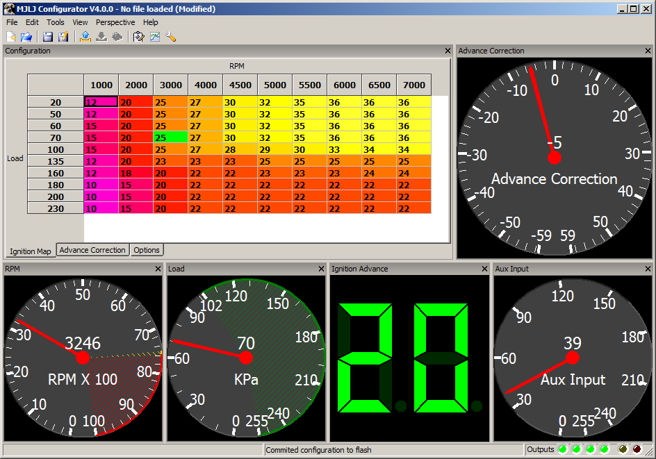

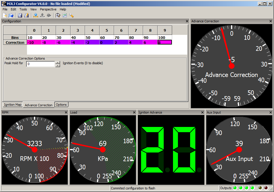

I've attached a few screen shots of the configuration software showing advance correction using the Aux input.

Sure.
The Aux input channel can be used to adjust the ignition advance calculated from the main ignition map. This adjustment- or 'correction' can be up to +/- 59 degrees.
When the aux input channel is read, the correction value is selected from the correction table based on the bin selected. In the example illustrated, we're reading a value of '39' from the aux channel. The bin selected is #3 (actually between 3 and 4). The interpolated ignition correction value is -5 degrees, and this is added to the ignition advance read from the map. So, 25 degrees - 5 degrees = 20 total degrees of advance.
