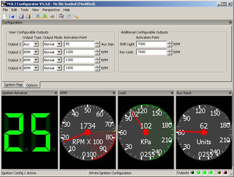

I tried to reproduce this, but I did not reproduce what you observed.
I am running with the default calibration, but after reviewing the code I don't see how changing calibration would affect things. Still, I will look at it a bit more.
If anyone else can reproduce this, showing results one way or another, that would be great!
- v3.3.0_aux_in.jpg (63.1 KiB) Viewed 34422 times
Here is screen recording of what I did (I prepared it in Linux, so I hope that you can watch it in winblows, it's DivX file):

But if AUX input gauge shows temp change, surely that part must be OK?
Anyway, I should measure voltage change at AUX pin (and ground) on the board? Nothing there. It reads 0.00V. But I just heated temp sensor from a room temperature to the body temperature. AUX input gauge went from 60 to 47.

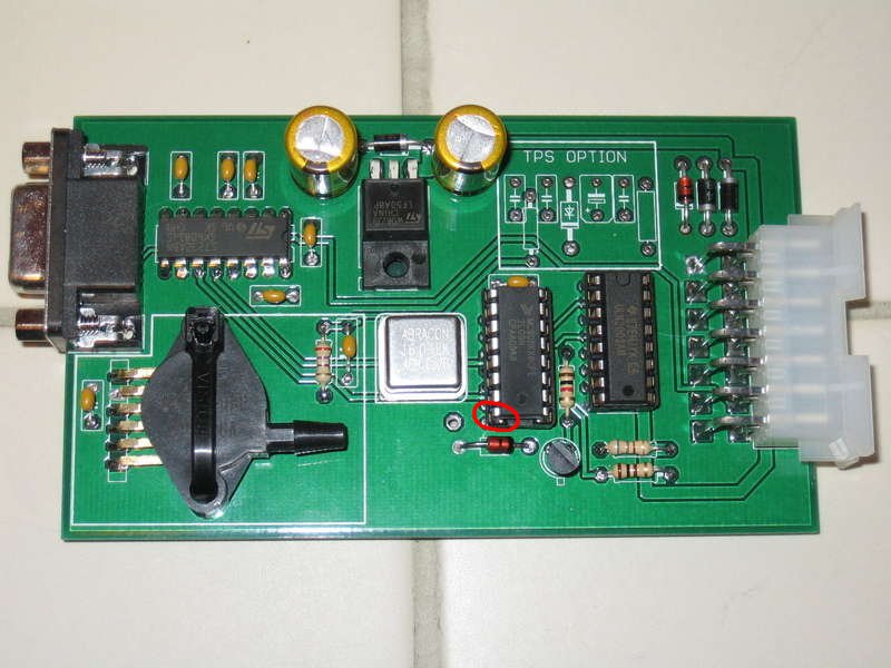

2. Using your volt-meter, monitor the ADC input pin right on the processor chip (pin 8 )
3. Compare the aux input gauge in the software against your volt meter- and test the user output in AUX mode- verify the voltage is changing with the gauge, and the output triggers correctly.

OK, I did it.
I used a cup with a cold (tap) water, and a cup with a warm (~65 Celsius or ~150 Fahrenheit) water and dipped temp sensor to each cup.
No voltage change. It stays at 0.00V.
But when I pulled out the sensor from cold to warm voltage raised to 1V and gradually went down. Change from warm to cold resulted in instant 0.00V. Again cold to warm up to ~1V and gradually down.
So I thought it may have something to do with a fact that cup for cold water was made of metal. I changed to ceramic one, and now again cold or warm it was 0.00V.
Again back to metal cup - 0.00V.
What voltage change should I expect here?
Just to mention all the time AUX gauge was changing from 70 (cold) to 25 (warm).
