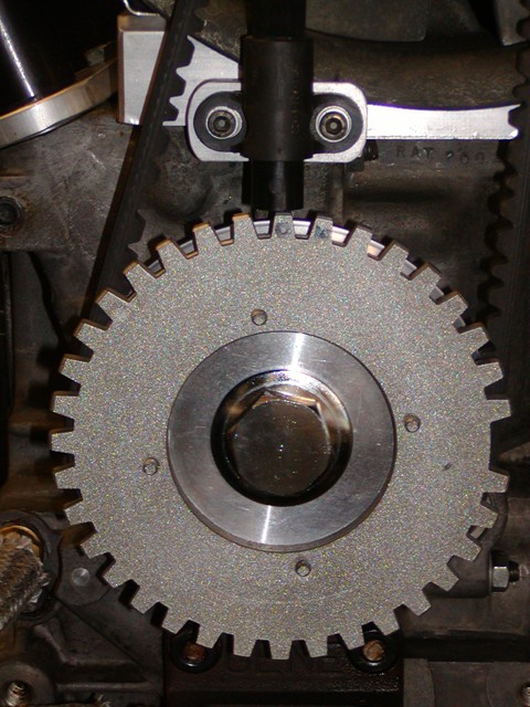

Sputtering to me sounds like too much advance, as long as you are 100% sure fuel is correct. Is your trigger wheel indexed properly, not trying to insult you, but are you sure?
Also a possibility that the crank sensor bracket is resonating, which causes the EDIS to get confused. Also could be non-resistor plugs causing EMF and confusing the EDIS.
My engine was jetted on a dyno with a distributor(009). I haven't changed the jetting since Megajolt, it's fine as I have done some full throttle shut downs to look at the plugs.
Paul, do you have a picture of your crank sensor and bracket?
Is it as solid as this? Notice the RAT stamp in the engine case, thanks Jake!
