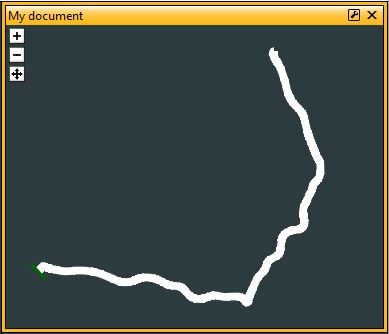

I figured out why my track wasn't displaying properly in AEM DA. After entering the units for my lat/long like you said via the channel properties I was getting a big straight line which really puzzled me when the data looked fine. After digging around the Track Editor (going into Track View Configuration by clicking the wrench for the track map and clicking the Edit button) I noticed there's an interesting setting. It had "Entire Log" with two boxes, first with 00.000 and second with 25:12.206. More interesting was in the drop down were various options that didn't quite make sense to me at first but there was one named "Fixed Range". This made me think that the track view was being calculated based on a defined time range of data in the log.
Sure enough I was right. I realized that the beginning of my data has the gps blank, so when my conversion script ran it was zero'ing out the data until the real gps lat/long began showing up. This was screwing up the Track Editor's calculations! It basically thought I was starting at coordinates 0,0, then suddenly jumping way over to my actual coordinates, making the range of values that had to fit on the track screen HUGE, and of course reducing my map to a straight line. If I changed the dropdown from "Entire Log" to "Fixed Range" and set the start time to something like 3 seconds (a time after which I had real lat/long values), and the end time to the end of my log (I used seconds, I think it might take other formats too like HH:MM:SS but not sure) and hit the "Calculate" button at the bottom of the Track Editor window my track popped up! Attached is what I get now.
So how to handle this? I decided I might as well throw out data that doesn't have any GPS coordinates to make it simple. Since GPS data is pretty frequent you aren't losing much data, less than 1 second worth if you are using 1hz resolution. I updated my script to v1.2 to add code to remove the data lacking gps coord in the beginning. This fixed things nicely
I've attached that version.

- track.JPG (20.97 KiB) Viewed 201541 times
