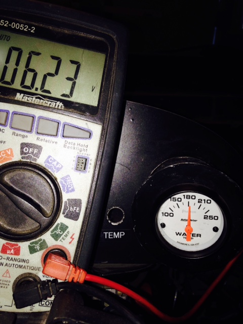

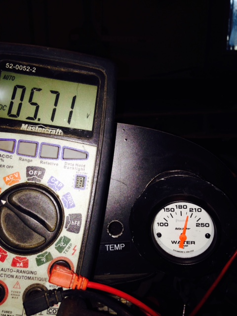

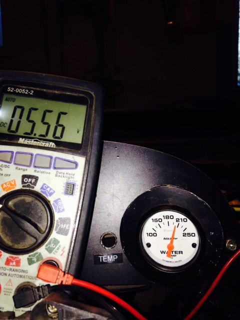

Thanks brentp for the reply.
Engine cold= 8.30 volts
75 degrees= my gauge will not show that low
100 degrees= 8.04 volts
125 degrees= 7.60 volts
150 degrees= 7.15
165 degrees= 6.66
180 degrees= 6.23
195 degrees= 5.71
near 210 degrees= 5.56
This is with the engine not running on cool down. I took the measurements form the ground and the sender terminal from the gauge.
With the engine running, the reading changes when I rev the engine or when I turn on the lights or the rad fan starts.
I find that the readings are high compared to what people are posting. Did I checked it wrong?
I can only attach 3 pictures, please send me your email by pm and I will send you the rest.
150 degrees= 7.15
165 degrees= 6.66
180 degrees= 6.23
195 degrees= 5.71

Thanks for the information. the voltages on your gauges output higher than the 5v input range on RaceCapture/Pro. In this case, we recommend a dedicated sensor. Some gauges output a lower range, and other gauge systems, like the Autometer Elite series have 0-5v datalogging outputs.
