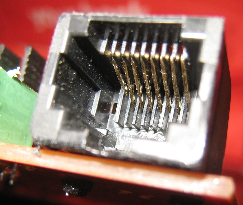

Long story somewhat shorter... I scoped the SPI interface and found the CS* line (chip select) wasn't being driven. Brent suspected a broken solder joint between connector and main board. That looked okay, but then I stared into the RJ45 and saw this... one dental tool later, the pin is in line with the other 7, and I have a MK1 that can read CAN broadcast data!
Tomorrow I modify the MegaSquirt to enable CAN broadcast, and I'll hook them together and have a single tablet dashboard/logger with all the data I want. Then I'll want to add more sensors....
- rcp-spi-bent.jpg (159.02 KiB) Viewed 7759 times

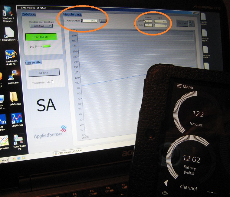

Another quick photo showing the CAN viewer that came with the sensor I lifted from work (dead project, good tool) and matching data on a dial on RCP dashboard.
- sa can to rcp.jpg (166.07 KiB) Viewed 7757 times
