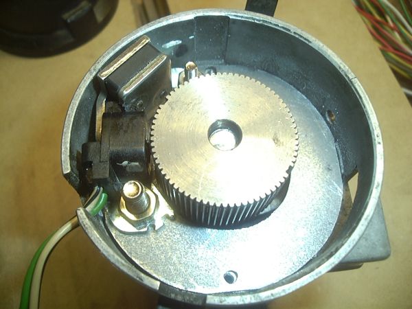

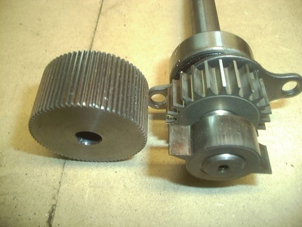

a bit of technical stuff: i dismantled the distributor completely, and took the shaft and gear stock to an engine reconditioner. i asked them to cut a slice off, and bore it for a light interference fit on the shaft, and left that to their discretion. after the idiot snapped my distributor shaft trying to hammer it on (eek!), i got another distributor and used a hydraulic press to fit. whoever bores the thing just needs to make sure the hole is dead centre as there isnt much tolerance for runout. i have the sensor no more than 1mm from the teeth.
to remove the teeth, i used a cheap dremel copy, with a tiny sanding disc ie about 10mm in diameter. it was surprisingly easy! i used 2 or maybe 3 little sanding discs to remove two teeth.

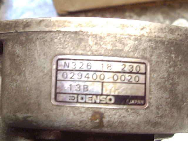

photos below show: my wheel, and the trigger wheels from the mazda part; a photo of the mazda CAS - those part numbers will guarantee you get the right part; my wheel press fit on my dist shaft; the mazda sensor mounted on a plate i hand made, and ready to be fixed into the distributor with the original base plate screws.
so, measure the diameter of your distributor shaft, and send me that with your address and i will get a piece of gear into the post. lastly, if for some reason you cant find the mazda part in norway, i am sure i could track down another one at a motor wrecker here in australia. after all, i am sure i will find a use for another spare sensor :)

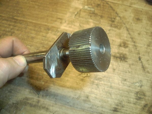

and the other photo i mentioned..

How on earth did you by the way figure out that this was the sensor to use ?!
alexander
Posts: 246
Location: sydney, australia.
Post by alexander »
Patriq wrote:How on earth did you by the way figure out that this was the sensor to use ?!
the question of alternative trigger wheels came up on the megasquirt discussion forum on Yahoo. someone on that group said that he had made this setup, and was kind enough to tell me the exact parts he used. how HE knew, i dont know.
alexander.

Progress !
i figured, that if the voltage increased that much just by moving a hex bolt such a small amount closer to the sensor when spinning it on a drill - then maybe the sensor was to far away from the trigger wheel after all.
So I modified it slightly to let it come even closer.
Bingo - spark !
(and by the way - I had soldered the cable correct the first time..... the polarity was correct when the same colour on the sensor cable and the EDIS-module cable was matched. But maybe on the installtion page it should include the same small images as on msextra.com, that shows what is ve+ on the standard Ford sensor and on the connector to it. Then it is very easy to see if the cable has been soldered correctly)
Well, so now I have spark from the EDIS unit - triggered by the standard Ford sensor to the 72-2 trigger wheel I made. But....
It only gives spark on average on every third event. I'm suspecting this is due to the teeth being to small for the standard Ford sensor. So next step is to try with the same type of sensor that Alexander has been so kind to send me !
