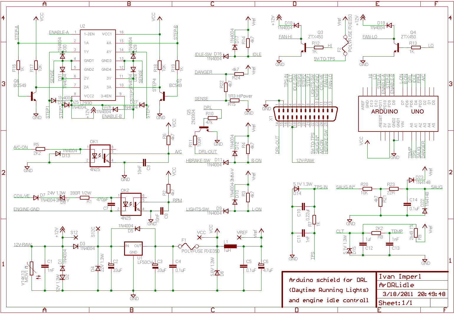

Aside from a timer, consider these:
- use a modern chip with built in current-limiting and over-heat protection.
- build a discrete H-Bridge using self-protecting MOSFETS. An L297 could provide the logic for driving the Mosfets.
- build a current sense circuit (using a low ohm current sense resistor) to trip an 'over current' condition, that the microcontroller could detect

Hi Brent, you replied to this thread both time while I was writing (and since English is not my native language it takes some time). :-)
I know that I can use some other chip, but than I must design new board. This one is designed for stepper motor, and it worked well on the bench, but big dissapointment when I tried it on the engine - could not move the throttle valve. At least not consistently.
So I am trying to do the best I can with what I have.
I was also thinking of adding a temperature sensor glued to the L293. How fast does the sensor read? Is it worth doing?
Anyway, you got me interested back, so I did some more programing, and decided to use average of four readings of overcurrent condition as a parameter for motor shutdown. It seems that it works OK (at the bench at least). :-)
Here is my circuit design:
DRL and idle control circuit

'87 BMW 316 E30
1600cc M10B16
petrol + LPG, MJLJ
Yvan
Posts: 86
Joined: Fri Feb 08, 2008 7:58 pm
Location: Kragujevac, Serbia
Post by Yvan »
Comments and suggestions are appreciated.
'87 BMW 316 E30
1600cc M10B16
petrol + LPG, MJLJ
Spockie-Tech
Posts: 152
Joined: Wed Jan 02, 2008 12:52 pm
Location: Melbourne, Australia
Post by Spockie-Tech »
Um..
It looks like too much circuitry and code for a general "comments and suggestions ?" request.
Do you have any specific areas you want suggestions on ? Otherwise, any potential readers would need to familairise themself with your whole purpose, design, code, build it themself and see if it works the way they would have done it. Not very likely.
Yvan
Posts: 86
Post by Yvan »
No, nothing specific. I guess that someone with more knowledge than me (I already wrote that I copied most of the circuits and code from the different locations on the Internet) could easily spot a weak point. Perhaps not.
Anyway, I hope that someone will find what I posted usefull.
'87 BMW 316 E30
1600cc M10B16
petrol + LPG, MJLJ
