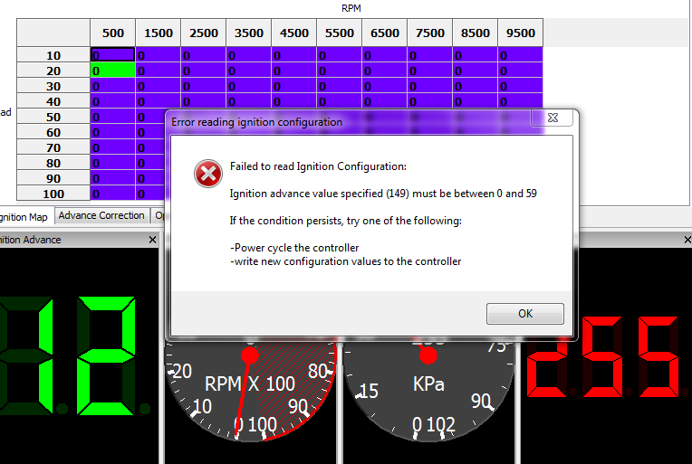

Success!!!....Kind of...so close I can taste it...
After getting the BT Module to be in 38,400 Baud and connecting to the MJ unit (jumper from 3rd pin in to RXT, jumper from 4th pin in to TXD, jumper from 2nd pin from MAP sensor to VCC, jumper from 3rd pin on MAP to GND) I was able to write my map, I thought. I did get a "timeout writing ignition config" error followed by a timeout reading runtime data and the BT module goes back to blinking so I thought it had finished and then wouldn't reconnect. I would powercycle the MJ unit as a "reset".
When the connection was reestablished I tried to read the map back I got the attached error indicating the was a bad advance value. The readings that came back were crap as well with the Load Values bins all saying 85 except Bin 7 that said 165. All RPM buckets were 8500...weird stuff like that.
What I discovered is that WRITING to the MJ takes much longer than I expected. If I waited ~38 seconds the bluetooth connection led would go steady again and I could now read the new values! Does anyone know how long it should take to write to the unit? I thought it would be faster than 38 seconds.
I still can't do a powercycle and then read the values...it's like it gets corrupted somehow. I can usually tell because the 2nd load bucket in the 1st RPM column will be green. This means I have no way of knowing if the values stored are correct and are getting corrupted on the connection OR if the values stored are bad/corrupted on power down.
[/img]
- Ignition Advance Error.PNG (80.14 KiB) Viewed 72157 times

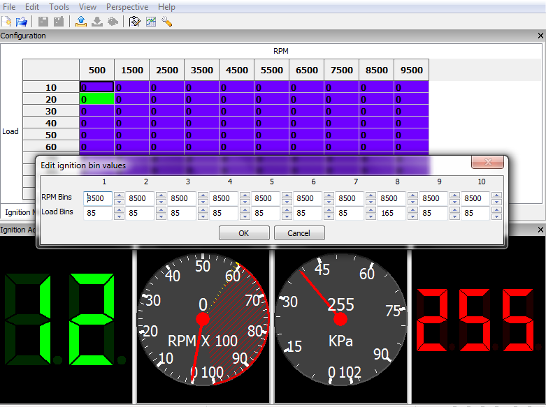

More updates:
At some point my map is getting corrupted. It only appears to happen in conjunction with a power cycle...I have no way to determine if it is during the power being shut down and the power being restored. At some point the Loan Bins and the RPM buckets get set to values that are impossible to save within the interface. You can see in the photo how the bins are set to the same values. The system won't allow these to be saved.
If I close the Configurator I don't get the error...unless power is lost to the MJ unit. Powering down the BT and then restarting it makes no difference. Any idea if the feature to save the RPM Bins can be made to work?
- Load Bins Error after powercycle.PNG (88.69 KiB) Viewed 72156 times

I realized my last post was a bit muddled...it was very late!
It appears that when power is lost the map is not retained correctly. I haven't yet verified with a serial cable if the initial connection being made could be what is causing the corruption or if it is really just the power loss. I am really hoping it is the connection being made as otherwise this unit won't work unless power is constantly applied, which obviously wouldn't be feasible.
I believe I found the problem. Per the manual:
The icon to commit to flash memory never shows up, even after the write process is complete. How do I activate the icon?MJ COnfigurator Manual wrote: Writing the Ignition Configuration
After editing the ignition map or controller options, you may write the changes to the controller. To do this, click the Write Ignition Configuration toolbar icon Mjlj write config toolbar.png to send your changes to the controller.
These changes are made to the Controller's volatile Random Access Memory Memory (RAM), which is used for the actual runtime operation. Therefore, the changes you make will affect the engine's operation. For example, if you are tuning the idle region and you alter ignition advance values in map where the engine is idling, you should observe a change in the engine's behavior once you write the configuration to the controller.
Important Note: Writing the ignition configuration only updates the Controller's RAM.
If changes are not persisted to the controller's Flash memory, the changes will be lost
if the controller loses power (e.g. ignition key turned to 'off').
This behavior is by design. Persisting the data to flash requires a significant amount of time
and momentarily pauses the controller's operation while the Flash memory is written.
Commit to Flash
To make the changes permanent in the Controller's Flash memory, Click the 'Commit configuration to Flash' toolbar icon Mjlj flash config toolbar.png. The controller will write the configuration to flash memory, and changes will be preserved across controller power-cycles.
