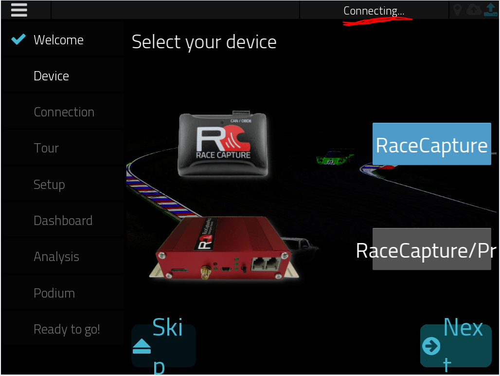

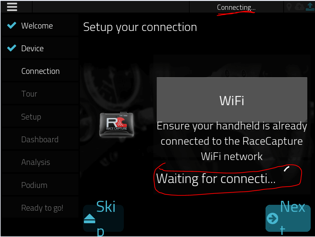

When I run the RC app from the tablet, it displayed the message "Connecting..." at the top of the screen.
Stepping thru the config wizard running on the tablet, I get as far as the "Device => Setup your connection" step. The UI displays a "Waiting for connecti..." message with a spinner, but it never connects. I waited several minutes just to be sure.

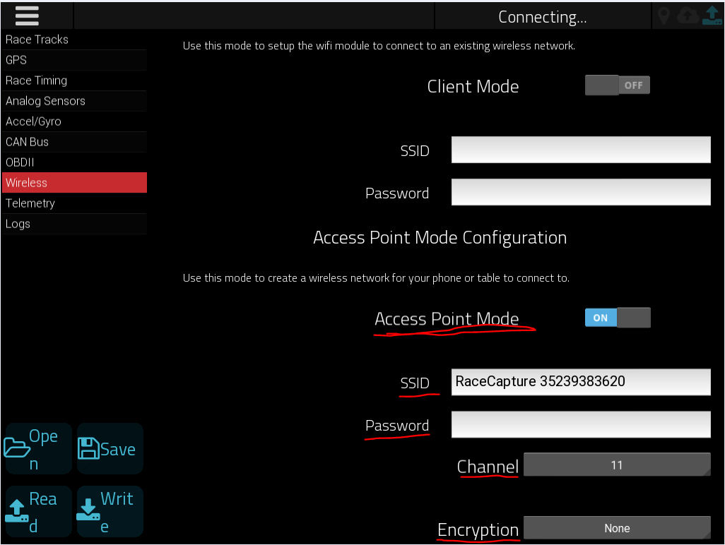

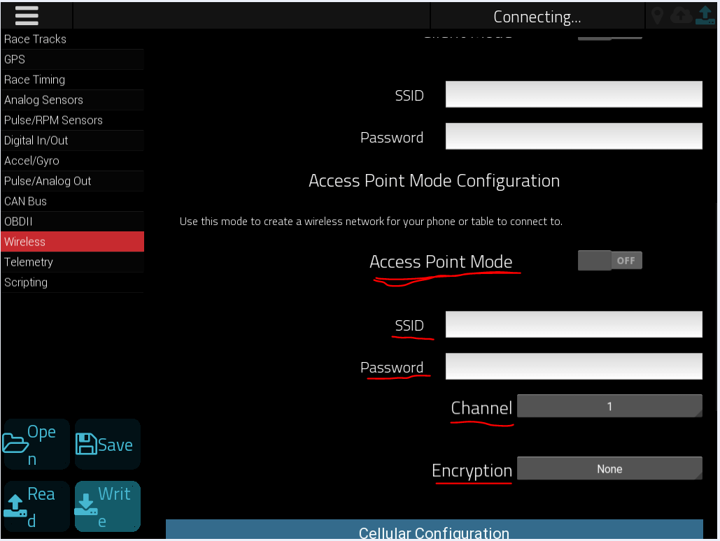

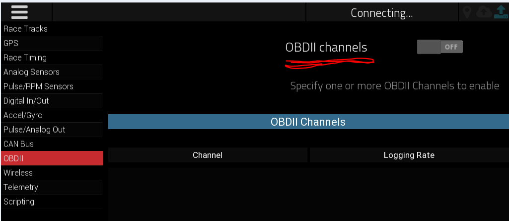

I clicked on the "Skip" button and then went to the Settings menu. Looking at the "Wireless" and ODBII settings I see the following:
Access Point Mode = "OFF"
SSID = [empty]
Password = [empty]
Channel = "1"
Encryption = "None"
ODBII Channels = "OFF"
Now when I "Open" the config file that I created on the PC, the Wireless and ODBII settings now show the settings saved from the PC over USB:
Access Point Mode = "ON"
SSID = "RaceCapture 35239383620"
Password = [empty]
Channel = "11"
Encryption = "None"

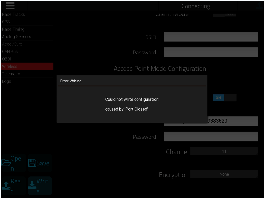

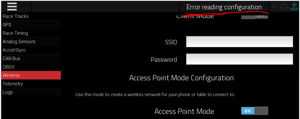

From the tablet over wi-fi, I tried Saving and Reading the config files.
On "Save" I get this message:
"Could not write configuration: caused by Port Closed"
On "Read" I get this message:
"Error reading configuration"

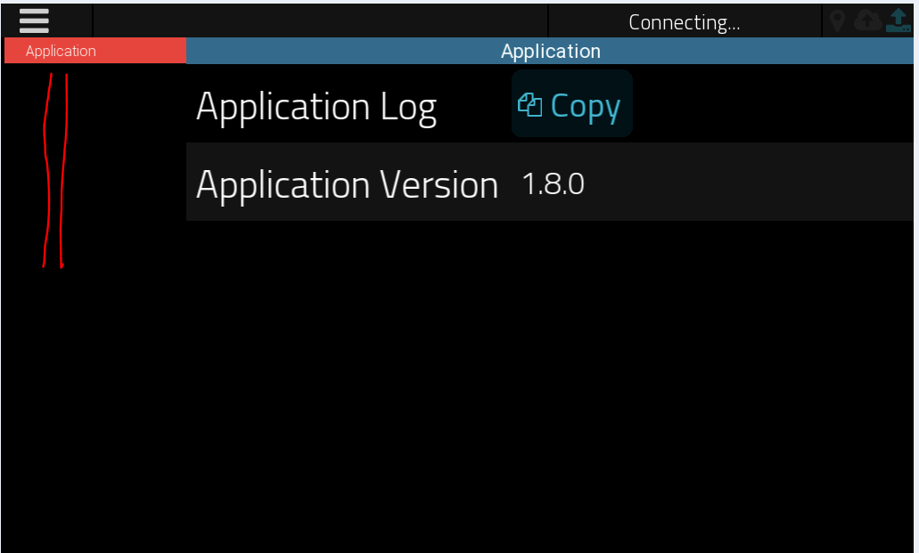

When to check on the status, I Click on the "Hamburger Icon" => "System Staus"
The Application menu is the only menu item displayed. No other status menu items are displayed.
Everything seems to work from the PC over USB, but in the car with the tablet connected to wi-fi and plugged into ODBII, the "Connecting..." message is always displayed and never goes away, the LED is always blinking green about once a second, no other colors are displayed. Is there something that I am not doing correctly?

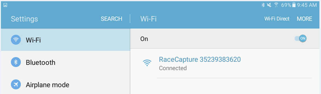

Thanks for the details. As you can see, the android device is not connecting (yet). Once it does connect, the current RaceCapture configuration is automatically read from the device and is shown in the setup view.
If you can't connect, whatever you see in the setup view, including config files you load, does not reflect the actual settings on RaceCapture. This is very important to understand.
What we should first do is establish your android device is truly connected to the WiFi network of RaceCapture.
