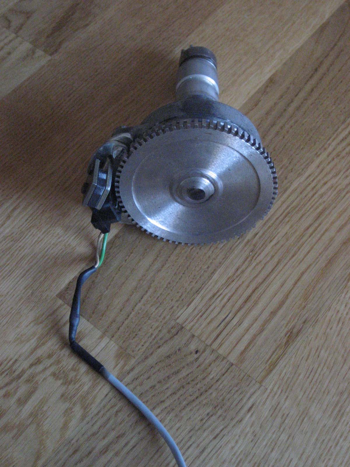

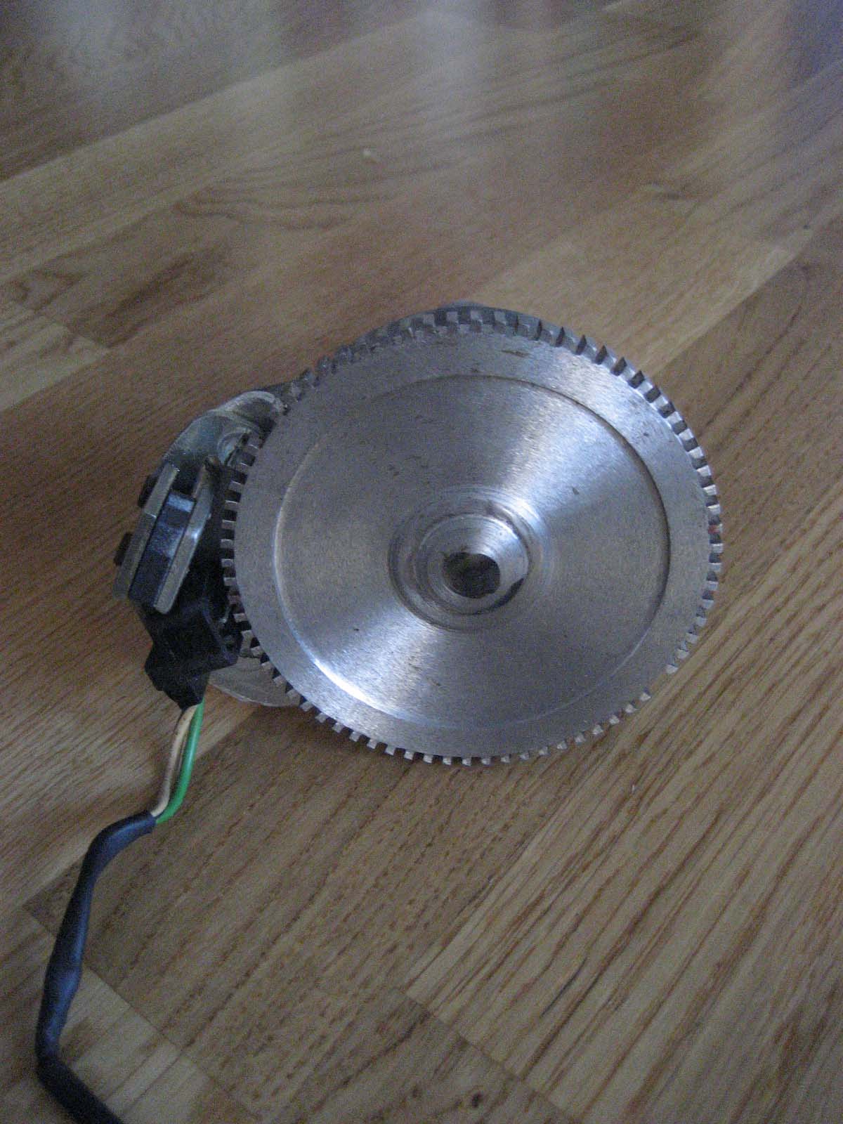

I have finally got around to make a new adapter for the new sensor. Here are images of the new sensor installed on the converted distributor.
I'm still waiting for parts for the carburettors I have taken apart - so I can't test the new installation just yet.
