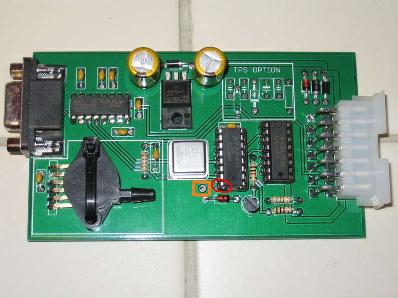

This requires a hardware modification. On the V3 board there is a pad near the processor labeled "AUX". We STRONGLY suggest you build a signal conditioning circuit to place in front of the AUX input to protect your precious processor! you have been warned!
Brent !
1. When you say there is a pad labeled "AUX" - is it the one I have boxed with orange in the enclosed image ? Or should I just solder a wire to the pin on the processor and run that wire up to the proto-board ? EDIT: Ignore this - the board was clearly marked AUX. I must be blind.
2. You mention that one should mount a plug at the end of the encasement for bringing in the signal. Couldn't one just snap one of the leads for the molex and bring in the signal at the same position on the molex as on the V4 board ? EDIT: Embarrasing - Shows that you should do your homework - more than one time. I now found that V4 has two more pins on its Molex. Well - I'll use one of the Molex pins I won't be using anyhow.
3. Any favourable point to pick up +5V for the signal circuit board ? Could it just be the Vref pin on the Molex for the TPS ?

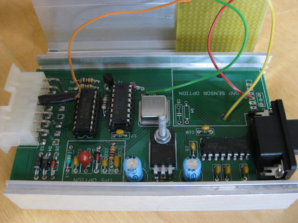

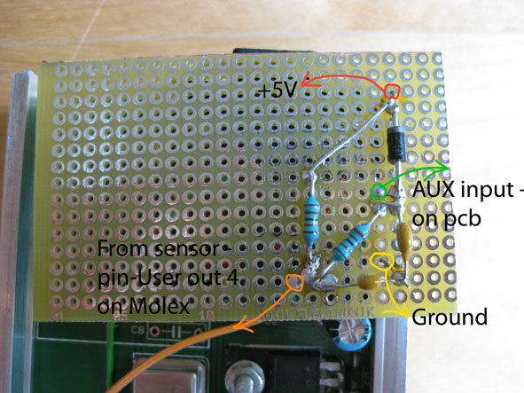

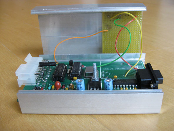

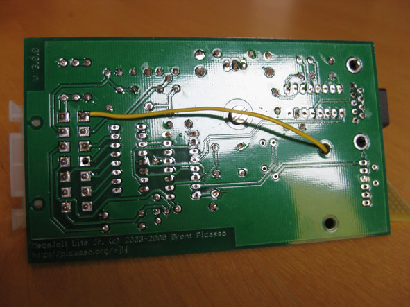

Here's what I did. I'd be glad if anyone checked it for me.
Soldered up the circuit previously mentioned on an experimental board. First photo is of it.
It is wired as the text says. Not too pretty, but it should work. I jumpered the components with snapped of leads - but solder eventually flowed over the bridges.
I picked up +5V from where the MAP-sensor otherwise would be. It had a vacant slot.
Sensor signal in I took from one of the pins on the Molex. I removed one of the pins from the pcb. When I removed the pin with the solder iron the plastic in the Molex melted slightly. Therefor the pin doesn't rest solidly in the molex. It could be good enough as it is, but I will add som glue to really make it stick. AUX in is wired to the slot on the pcb, and ground to the pin on the molex where it is soldered on the backside.
Experimental board with signal circuit to protect processor. Text shows how it is wired.
How board is wired to pcb.
Another photo of experimental board to pcb.

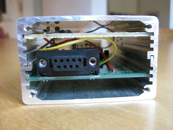

More photos of installment.
Wiring of ground for experimental board.
How it looks installed in case.

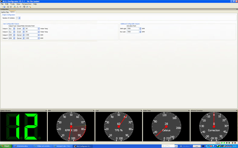

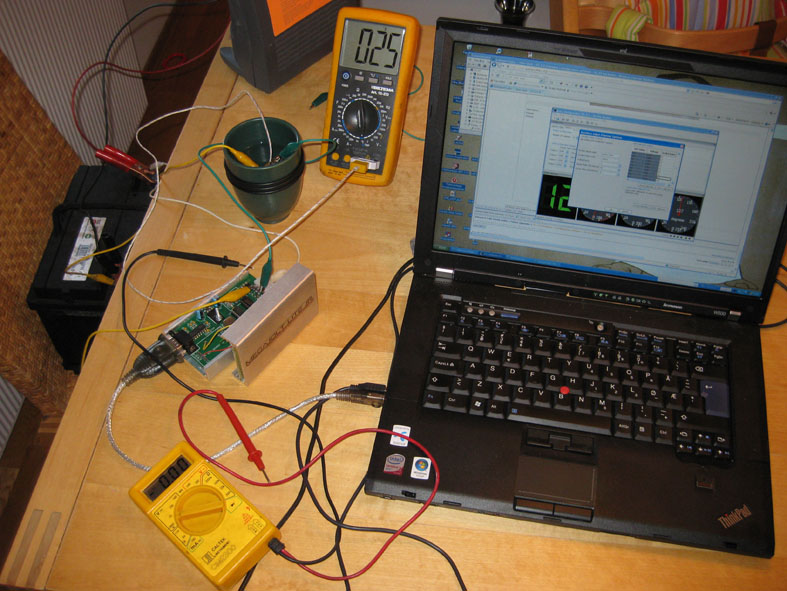

I've now started to test the aux input with my V3 board. I simply put the sensor connected to the aux input and read the temperature corresponding to the voltage reading for each bin and entered it from 0dgsC to 99dgsC. It took a little while, but was interesting to follow.
I then tried it out with the configurable outputs. I set output 1 to activate with AUX inverted at 60 degrees C, and output two to activate with AUX inverted at 85 degrees C. Both activated properly. The red "lights" in the configurator software was lit, and I confirmed that output pin 1 and output pin 2 had ground after the AUX had reached 60 dgs and 85 dgs respectively.
But..... after temperature was lowered below 60dgs , actually down to 30 dgs - both output 1 and output 2 was still active.
Shouldn't they have come off ?
Other than that it works flawlessly it seems so far.
