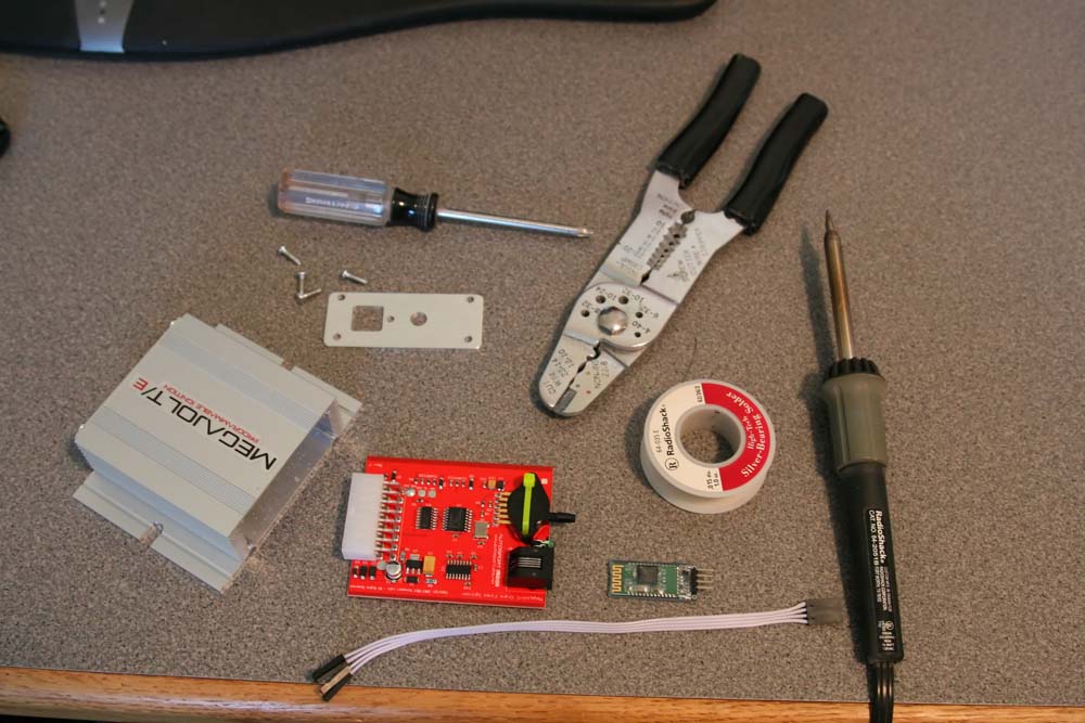

In order to make your Android device communicate with the MegaJolt/E, you will need to install a serial to Bluetooth converter. You can get one here: http://dx.com/p/jy-mcu-arduino-bluetoot ... ule-104299
The first picture below shows most of the items you will need.
A torx tip screwdriver to get the MegaJolt/E apart.
A soldering iron and some fine or High Tech Silver Bearing Solder.
A pair of wire strippers/cutters.
A JY-MCU Serial to Bluetooth converter.
Some double sided foam tape (not shown).
Some shoe goo, or other high quality glue that can withstand heat and cold (not shown).

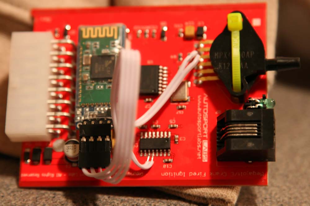

First thing to do is take one end off the MegaJolt/E. It does not matter which end. The board will slide out either side.
Once the board is out of the case, locate the ground and power pins on the MAP sensor. You will notice one of the pins has a notch in it, that is pin 1. Pin 2 is ground and pin 3 is +5 volts. Solder the power and ground wires for the JY-MCU to these 2 connectors. The back side of the JY-MCU usually has s silk screen that identifies what pins are what.
Next locate the RS323 driver. It is the black rectangle closest to the RJ-11 port. On the side of that chip closest to the edge of the board are the TTL transmit and receive pins. We need to solder the transmit and receive pins on the JY-MCU to these 2 pins. In the second picture below you see 2 wires soldered to the driver, the pin on the left is receive and the pin on the right is transmit. Solder the wire connected to Transmit on the JY-MCU to the Receive pin Receive to Transmit. If there are arrows printed on the back of your JY-MCU, ignore them and pay attention to the transmit and receive labels instead. Some of the arrows are printed from the perspective of the JY-MCU, others are printed from the perspective of the device you are connecting it to.
Now, power up your MegaJolt/E. There should be an LED on the JY-MCU that flashes to indicate it has power but no connection has been made. Pair your Android device and load up MegaJolt Android. Under settings, pick the Bluetooth device you just installed in your MegaJolt/E and return to the home screen. Click Connect to MegaJolt Lite. After a couple seconds the light should turn solid to indicate a connection was made. As well, the RPM High and Low labels on the screen should both say 255. If that is the case you are good to go. If not, you may need to switch your transmit and receive lines. As you can see in the picture, I used the solid connector on the board and cut off the loose ends. I would do that the other way around if I did this again. That would make it much easier to switch TX and RX if I got them backwards.
Now, use your foam tape and stick the JY-MCU to the MegaJolt/E. Make sure to stick the tape to the board only and not any of the components soldered to the board. Then use a little dab of glue to hold the wires in place. Again, only put glue on the board and your wires, not the components on the board. This is not strictly necessary, but it will help to prevent cracks in the solder.
Put the board back in the case and button it back up.
