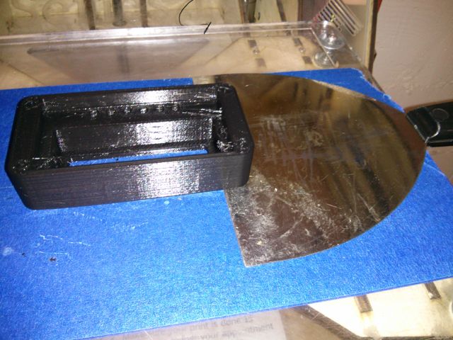

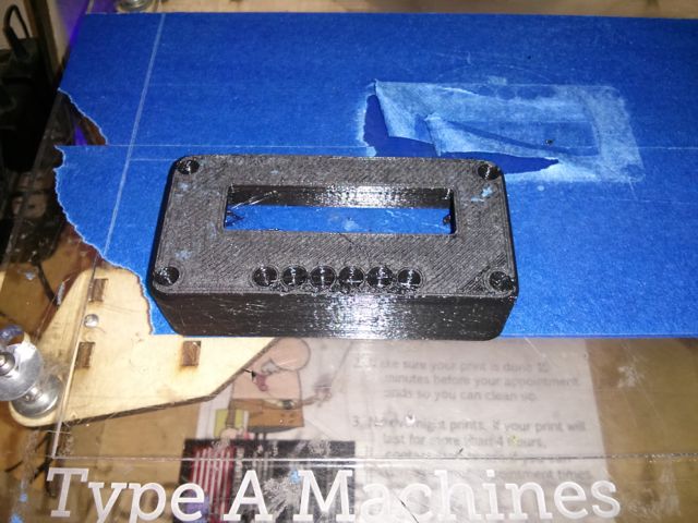

Having said all of that, my first print turned out pretty decent:
The obvious advantage to 3D printing is that the process, once initialized, is entirely automatic. The other advantage is that there are fewer constraints on the types of shapes that can be made, and those constraints are easy to understand and work around once you understand how the machines work. Once you have your part, you can instantly tell if you're on the right track before you invest in more costly manufacturing.
The obvious disadvantages are speed and quality. Complex or fine detailed prints can take many hours. These machines work by extruding thin streams of plastic along 2D paths, building up the object one slice at a time. And it shows in the results. "Wow, a 3D printer made that?" is not something I expect to hear any time soon. That's when things go well. There are plenty of gotchas and pitfalls that can cause prints to fail: warping, stringing, blobs forming, parts falling over. Combine that with slow print speeds and limited available print time, and there's a huge potential for frustration.

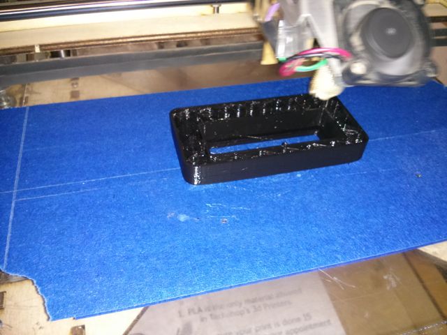

- Print in progress
- 3d-prints1.jpg (54.68 KiB) Viewed 22105 times
- Scraping the first part off the build table.
- 3d-prints3.jpg (65.37 KiB) Viewed 22105 times
- Front face, note some of the details are distorted. Also note the finish quality isn't the greatest. I make switch to printing upside-down to avoid this.
- 3d-prints4.jpg (63.17 KiB) Viewed 22105 times

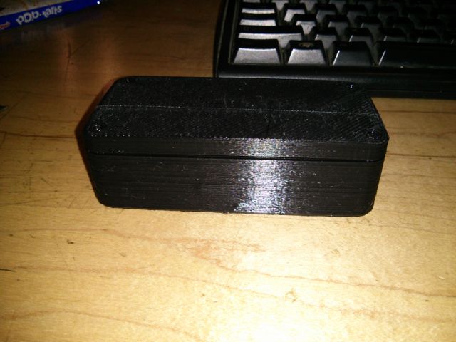

Printing both top and bottom pieces took about 4 hours. About an hour each, plus some down time fiddling with settings. I designed the rear cover while the main body was printing. Once both parts were done, I did a trial fit and was shocked to discover that the parts actually mated together correctly, and the screw holes were properly aligned (I can hear you snickering at the last sentence. Grow up, internet!).

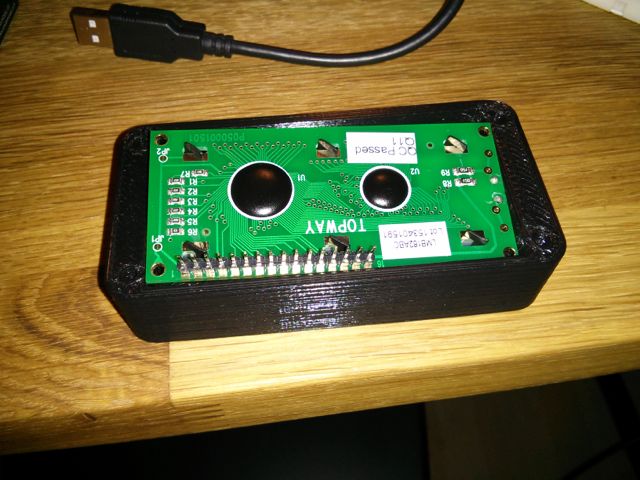

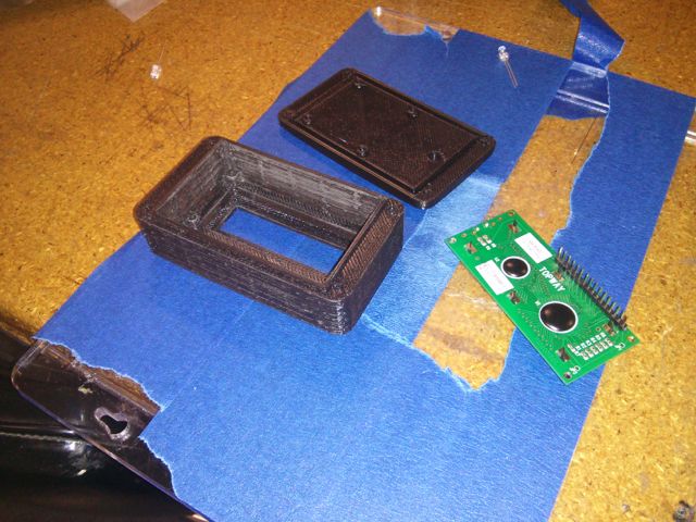

I couldn't wait to get come home and try installing the parts. But I was immediately disappointed. Neither the LCD nor LED fit correctly.
- It seems I got the dimensions of the LCD wrong, or else didn't allow enough of a clearance.
- 3d-prints6.jpg (62.4 KiB) Viewed 22102 times

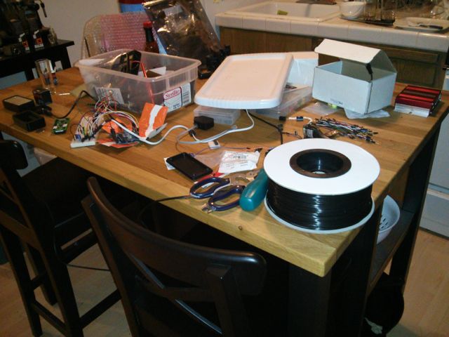

- The wreckage that has become my kitchen(ette).
- 3d-prints7.jpg (54.5 KiB) Viewed 22102 times
- Top and bottom cover actually fitting together. Amazing!
- 3d-prints5.jpg (46.36 KiB) Viewed 22103 times

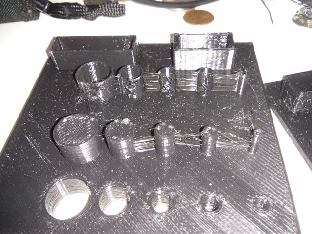

I went back to techshop to see where I went wrong. I decide to print some test objects, to try and determine how accurate the printer is. What I discovered is that holes below about 7mm print slightly under-sized with the settings I used. 10mm and larger holes print pretty true to their nominal dimensions.
The LED dimensions in the CAD file were correct. 5mm LEDs are actually about 4.95mm in diameter on the body, and 5.5mm in diameter at the flange. So a hole diameter of 5mm should give you a nice, snug fit.
For the LCD, on the other hand, it seems I just plain got the dimensions wrong. That's what I get for hand-measuring the part instead of looking up the datasheet and working from the engineering specifications.
I've updated the CAD drawings based on this experience. I've moved the LED holes further apart, because it seems their proximity caused distortions in the print. So they're now spaced .400" instead of .300". I've added an "LED Clearance" parameter to the model, so I can fudge the LED diameter and print a slightly larger hole. I will make another test object so I can see how print settings affect tolerances. Or, I could just plan on chasing all the holes with a tap drill. Finally, I've added features to the model to secure the LCD inside the housing, and secure the other electronics to the rear cover, and a hole for the cable to pass through (going with a pig-tail for now, since I have no idea what the circuit layout will look light).
One final thing I was relieved to discover is that I was able to secure the rear cover with plastic screws, and the case didn't crack. What this means is that if I can get a good print, I can actually use it for testing. It won't be pretty, but it will allow me to refine my design before sending it out to be made by someone who knows what the hell they are doing.
- A test object with some features that failed.
- 3d-prints8.jpg (70.76 KiB) Viewed 22101 times

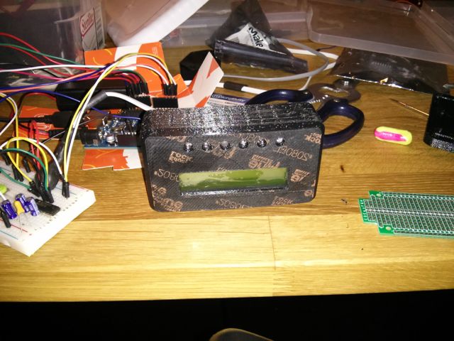

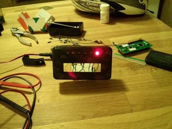

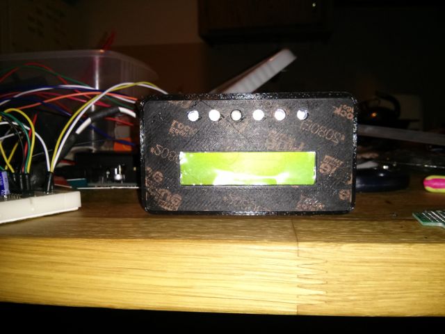

I ran another print tonight. Looks like the changes to the CAD file were spot on, and the components all fit correctly now. I'm not entirely happy with the results. I mean, let's face it: it's ugly. I've been having the trouble with lots of "string" forming, and nobody quite seems to know why. I've also been having trouble with part warpage.
For now, I'm satisfied that the interior of the enclosure is reasonably close to correct. And what I've got is good enough that I can continue hacking on the electronics, the goal of which is to miniaturize my prototype to the point that it fits into the enclosure. Once that's accomplished, I'll revisit the enclosure.
- LEDs and LCD inside the enclosure.
- 3d-printing2.jpg (65.82 KiB) Viewed 22087 times
- 3d-printing3.jpg (47.34 KiB) Viewed 22087 times
- Rev 2 enclosure coming off the build platform.
- 3d-printing1.jpg (70.87 KiB) Viewed 22088 times

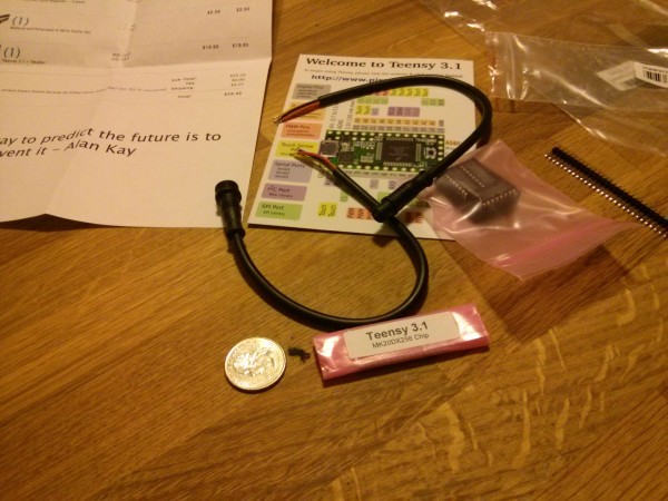

Went on a bit of an on-line shopping spree today. Ordered some parts for "Rev2".
* This Display: http://www.buydisplay.com/default/240x6 ... odule.html
* Teensy 3.1: http://www.adafruit.com/products/1625
* Waterproof 4-wire cable set http://www.adafruit.com/products/744
These are all speculative purchases. I'm going to keep hacking on my Rev 1 design because I need something working when the season starts in the middle of next month.
If I can get all this working, rev 2 will be a huge improvement over rev1. The 240x64 pixel display is plenty big enough to be seen and has more pixels than necessary. I did a test visualizatoin with GIMP and a laser printer). I opted to get the thinner FFC variant. I've never worked with FFC style connections. It will require fabricating a PCB, and I've never done that either. But I know people who have and can help with that.
Teensy 3.1 is an arduino pro mini on steroids. It seems like the way to go. With 34 IO pins, I can feel free to do whatever I want. I don't have to fret about using 7 whole IO pins for the display, or worry that a JSON parser won't fit in 2k of ram. Plus there's 3 on-board UARTS, so that leaves open some interesting possibilities. For example, the display could have serial pass-through. Meaning you could daisy chain serial peripherals, and have your display cake and with some telemetry icing. And I still have another UART left over for debugging. Plus it's got USB on-board, so I can be indecisive and reprogram it easily. At $20, it's really a bargain. I'm not sure why you'd bother with anything else.

My order from Adafruit arrived. Still waiting for the LCD. I have enough information and whatnot to make a detailed mock-up of rev 2. So I'll spend some time on that while I wait for the LCD to arrive. The Type A machine printers are fine for that sort of thing. I'm just not sure I feel comfortable using them for the final product. The prints tend to be porous, and there's no easy way to fix that.

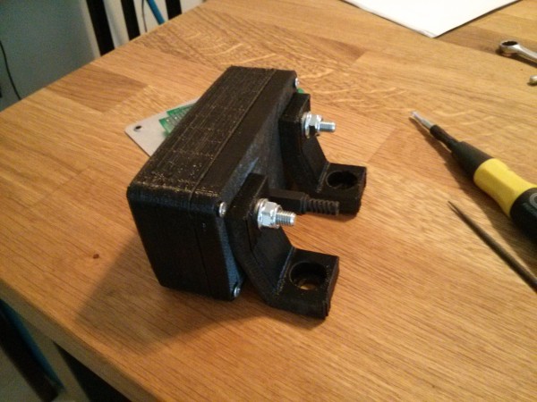

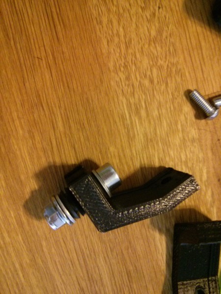

- IMG_20140303_225116.jpg (71.56 KiB) Viewed 22023 times
- Will definitely want to integrate the mounting brackets rather than have them bolt on. Also M6 is probably over-kill.
- IMG_20140303_105414.jpg (67.24 KiB) Viewed 22023 times
- My attempt at rubber isolation mounts. It could work.
- IMG_20140303_103829.jpg (71.06 KiB) Viewed 22023 times

- Enclosure with components inside
- IMG_20140224_010202.jpg (60.69 KiB) Viewed 22020 times
- Test with solitary LED. On angle, they are *blinding*. I may need to tone it down a bit.
- IMG_20140228_222020.jpg (78.39 KiB) Viewed 22020 times

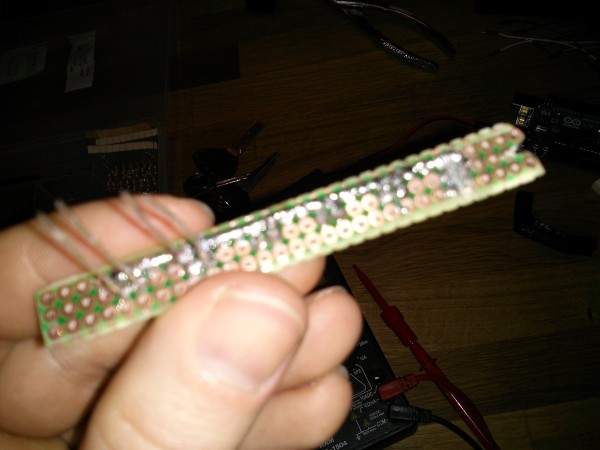

- My LED strip. About as good as I can manage on this kind of perfboard. I'm kinda regretting not integrating resistors into this board already. I don't dare try to fix it though -- already burned up two LEDs doing that.
- IMG_20140228_214859.jpg (46.5 KiB) Viewed 22022 times
