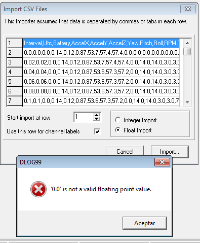

Hi All,
I'm trying to use the tool RCP2GEMS with the example file but something is not working.
Steps I did.
1. git clone https://github.com/autosportlabs/RCP2GEMS.git
2. cd RCP2GEMS/
3. ./python/RCP_conv.py RCP_Demo.LOG RCP_Demo_dlog.csv
its output was:
0 lines skipped
(True, 'RCP_Demo_dlog.csv')
Then I opened Dlog99 (I downloaded it from http://www.gems.co.uk/?content=pages&id ... -downloads) I chose File Import and selected RCP_Demo_dlog.csv, Float Import, but I am getting the "0.0 is not a valid floating point value" (I attached a picture of the error message).
Do you have any idea of what could be wrong?
Thanks in advance.
- Error I'm getting.
- Selection_028.png (14.71 KiB) Viewed 409000 times

Hi mavab91, I want to say I've seen that error before as well.
2 suggestions to try:
1. If that file is open in another program (Excel), close that program and try the import again.
2. Try opening the .csv file in Excel, then re-saving (maybe with a new name) as a csv and closing.
Hope this helps.

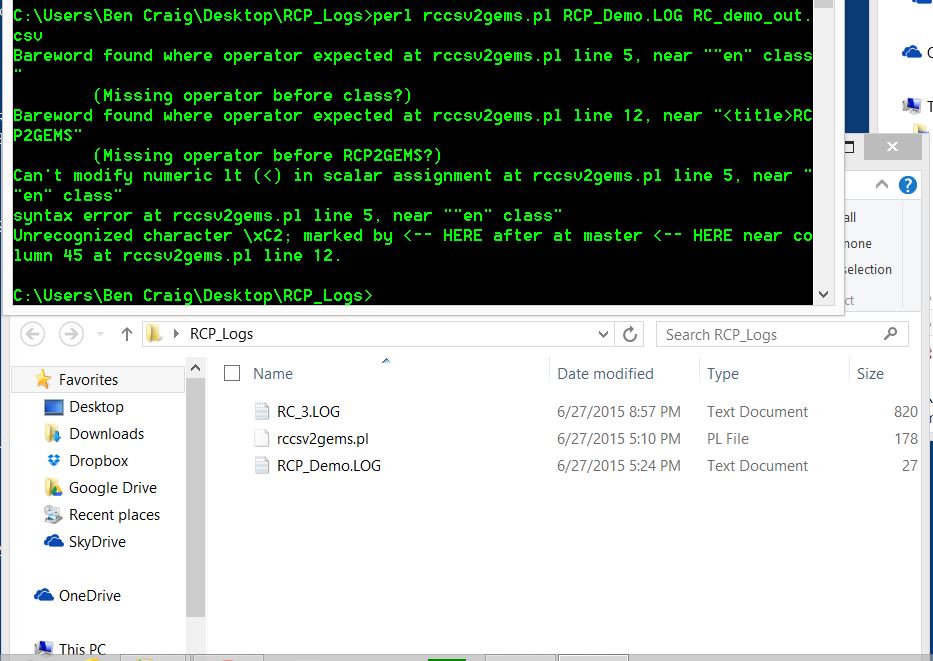

All,
Hopefully simple question / answer, but I can't get the script to work... I'm by no means a programmer so I'm sure it's user error.
I've installed Perl from: http://padre.perlide.org/download.html , and as described in the RCP3GEMS Readme installed Text::CSV, and am now recieving the following error while trying to run the script on either my own logs or the example posted on github.
Does anyone know what's going wrong here?
Ben
Ben
- RCP2GEMS_error.JPG (117.3 KiB) Viewed 408798 times
Try opening your RCP_demo.LOG file in notepad - I bet it's really an HTML file. Did you rightclick a link and say SAVE AS or just click the link? Try getting the real log file, and it should be better. Or I could be completely wrong.

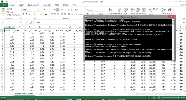

I am trying to use the perl script to convert a *.csv file I acquired from my datalogger (my datalogger is not a RCP one) and it seems like it can't recognize the time column in the *.csv. The first column in my file is the time column. I attach some photos with the *.csv and cmd with error.
- csv_pic.jpg (197.42 KiB) Viewed 407993 times
JMcDonough
- Posts: 70
- Location: Detroit, MI
Since the perl script was written specifically to convert RCP's .log files to .csv's that can be imported into DLOG99, you aren't going to have any success running the perl script on your data that is already in .csv form. You might try importing your .csv into dlog99 directly and see if that works.eangelov wrote:I am trying to use the perl script to convert a *.csv file I acquired from my datalogger (my datalogger is not a RCP one) and it seems like it can't recognize the time column in the *.csv. The first column in my file is the time column. I attach some photos with the *.csv and cmd with error.
