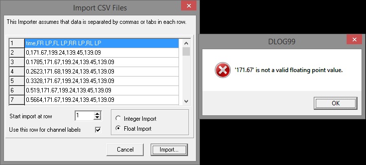

I've tried that as well but I always get an error message saying: "'171.67(random float number)' is not a valid floating point value". I've read in this thread already that another guy had the same problem but the proposed solutions didn't seem to work on me. I also attached a photo with the error message below.

I opened the file in excel, re-saved as a .csv, then got the same error on the first time value that has an additional "." in the number (ex: 1.001.741). I cropped that file down to only include data at time values less than that and it worked. You'll need to remove the extra "." from the higher numbers (ex: 1001.741) for it to work.eangelov wrote:I've tried that as well but I always get an error message saying: "'171.67(random float number)' is not a valid floating point value". I've read in this thread already that another guy had the same problem but the proposed solutions didn't seem to work on me. I also attached a photo with the error message below.

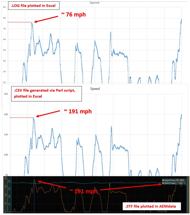

Hello All,
I am a brand new RCP user here, just received my kit late last week. I have spent a fair bit of time with AEMdata, so my first order of business was to generate a dataset with my RCP and get it into to AEMdata and see how everything worked. Thank you to everyone who has contributed to this topic! The process was fairly easy to follow.
I am seeing an anomaly with my speed channel's values after conversion. I was wondering if anyone else was seeing the same, or could help me get it sorted. It appears that my speed channel is multiplied by a factor of ~2.5 after running the Perl script. I opened the .LOG file before conversion, and the speed is correct. I opened the .CSV file after conversion and my speed values are multiplied. I then created the .STF file and the multiplied speed carries through to there too. All other channels appear to convert correctly. Any ideas? What am I doing wrong?
I've attached a few screen grabs showing the speed trace as plotted from the .LOG, .CSV, and .STF files; respectively. I was actually going approximately 76mph, I assure you I was NOT going 191mph!
Cheers,
Tyler
Cheers,
Tyler
- Speed Mult.JPG (99.81 KiB) Viewed 278020 times
JMcDonough
- Posts: 70
- Location: Detroit, MI
RE: Speed multiplier?
I think there might be a conversion between kph and mph going on twice (1mph = 1.609kph, 1.609^2 =2.589
Can you post the raw log file?
Josh
Re: RE: Speed multiplier?
Josh, that is it! I realized that the problem stemmed from my having two Speed channels in the same log; one from GPS, one from OBDII. I've created a new dataset and the conversion now works as intended. Thanks for pointing me in the right direction!JMcDonough wrote:I think there might be a conversion between kph and mph going on twice (1mph = 1.609kph, 1.609^2 =2.589
