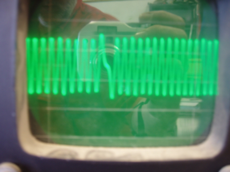

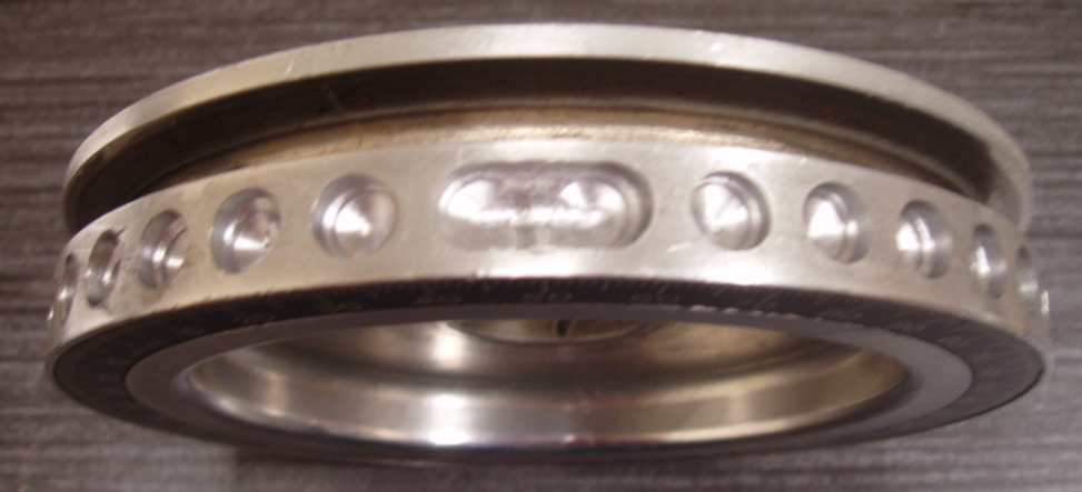

I modified an aftermarket VW pulley with holes instead of teeth.
The VR signal looks good to me, just wanted to see if I am correct?
Also, what voltage peak to peak should I shoot for when I space the
pickup from the pulley?
Pardon the blurry picture, I was holding the camera in one hand and
a cordless drill with the pulley in the other and the camera caught
several retraces during exposure.

Very nice lateral thinking there
... and nice waveform - looks like you've got it running very concentrically
Can't exactly remember what I measured on a normal toothed wheel - in the region of 1.5v - 20v pk-to-pk (higher rpm = higher voltage) IIRC
I don't think you need an attenuator - you're not going to find your metal between the holes suddenly producing e.g. 2x the voltage that a normal wheel produces.
Ford use/used all sorts of wheels - from bent tin plate to webbed spokes on flywheels and as far as I know, they didn't use different EDIS's depending on the trigger wheel construction
I'm impressed - and it's given me a few ideas ... thanks for the posting!

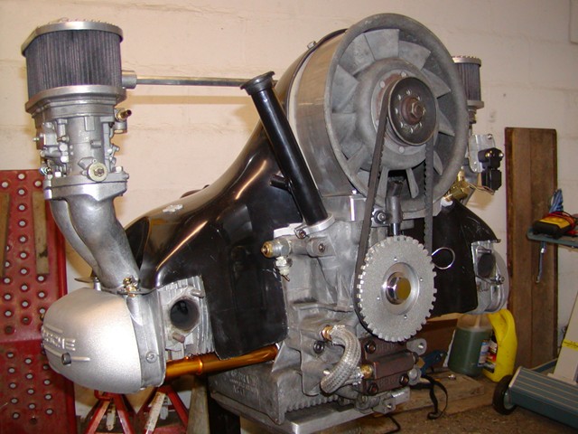

There was no way to change the location of the "missing tooth" now, so I have
machined a second keyway into the pulley at 130 degrees from the stock location.
This puts the VR sensor between the belt like the picture above.
I was hoping to get it going this last weekend, however made a terrible mistake

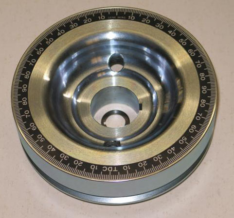

Thanks, I figure it out kind of after the fact. I think i am going to get one(cheaper one) for my vw and drill it out the same way.DannyP wrote:It might be a Gene Berg Equalizer, big heavy steel. A harmonic balancer for VW, kind of offsets the lightweight flywheel most use.
It would be for my 68 bus with an otherwise bone stock 1600 dp motor. I figure the extra weight can only help in my application.
BTW Alexander, excellent thinking on the holes. I had pondered 35 holes in an aluminum pulley filled with threaded plugs, but in the end the stock EDIS pulley worked well, much modified. I like the Berg pulley idea. What thickness and cylinder bore are the spacers? There are many other sources, aircooled.net, SCAT, evwparts, etc. I have stacked spacers on my engine as I didn't want to wait for custom cut spacers. No problem at all.

Indeed, it is a Berg Equalizer pulley.DannyP wrote:It might be a Gene Berg Equalizer, big heavy steel. A harmonic balancer for VW, kind of offsets the lightweight flywheel most use.
Spacers are in and installed. Old 90.5 case bore. The cylinders are thick wall 90.5's that I had the case side of them machined to the old thin wall 90.5 bore to retain more strength for 10mm case savers. I needed .070 which is an odd thickness not to mention that no one carries the old thin wall stuff anymore.DannyP wrote:BTW Alexander, excellent thinking on the holes. I had pondered 35 holes in an aluminum pulley filled with threaded plugs, but in the end the stock EDIS pulley worked well, much modified. I like the Berg pulley idea. What thickness and cylinder bore are the spacers? There are many other sources, aircooled.net, SCAT, evwparts, etc. I have stacked spacers on my engine as I didn't want to wait for custom cut spacers. No problem at all.
