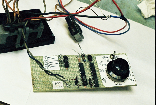

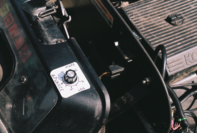

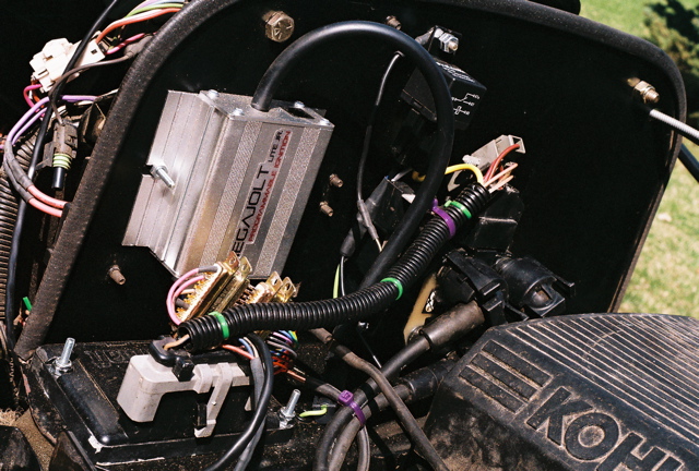

Ok, its running & partially tuned. Already there is a big difference in performance, from the old fixed advance to an optimized spark advance. 100 hours a year running this engine, and 22 degree fixed ignition just wasn't doing it. The odd fire twin is running an MJLJ-V4 and an EDIS setup, but only one coil pack. More pictures & description are on PHOTOBUCKET in album CrankTriggerIgn. I attached pictures of the MANUAL ADVANCE KNOB, my trigger wheel emulator circuit, and the ignition system. Just by increasing advance, idle went from 1500 rpm to 2000 rpm. Top speed went from 3700 rpm to 4000 rpm, despite the governor. Later, I expect to get 5 acres mowed without running out of gas. Bruce Roe
