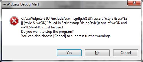

Oh wait just found a bug. If you try to import a datalog you get a wxwidgets error.

The same thing also happens under Windows 7, so this doesn't appear to be confined to Wine. Screenshot attached as an attachment. Log file sent to Brent via PM.

brentp wrote:GameboyRMH, does this happen when you start RaceAnalyzer fresh and then click the green down arrow on the toolbar?
What happens if you first create a new RaceEvent (toolbar icon on left size with lightning bolt), and then click the green import arrow?
The error is complaining about how a dialog box is configured, but I can't reproduce on my end. It seems to be happening for some and not others. Knowing what steps are involved will help nail this one down.
Also, did you get the "error reading datalog file header" after you clicked "No" on the first error?
thanks,
Tried a couple of different methods. I started RaceAnalyzer fresh, pressed the green down arrow, created a new race event, imported Aaron.log - left all fields selected, then when I clicked Import it gave the same error.
Then I started RaceAnalyzer fresh again, created a new event with the toolbar button, pressed the green down arrow, imported Aaron.log, left all fields selected, hit Import and got the same error.
And yes I always get the "error reading datalog file header" error after clicking "No" on the first error. "Cancel" brings up the same error and "Yes" crashes the program.

brentp wrote:This is interesting - I'm not seeing this error currently.
That's because you made it so you know how to use it. ;)
Here's how I recreate it:
Start a new session of Race Analyzer 1.16.0
File -> Open Race Event
Select the default rc_0.radb that came with Race Analyzer.
"Error Opening Failed to open Race Event: Failed to query for datalog Ids" message appears. Click OK.
File -> Import Datalog -> browse to a test .log file. Next, Next
"Unhandled exception An unhandled exception occurred. Press "Abort" to terminate the program, "Retry" to exit the program normally and "Ignore" to try to continue." Click Ignore, then Next, then Import.
Then you get the widgets error noted above.
It appears that the default .radb file that ships with Race Analyzer is not valid. My suggestion would be to either not include a .radb file or to include one that matches the default hardware configuration, which is set to log GPS and accelerometer data.
Since the alpha users must not have this problem, I figured it must be user error. So I figured out the correct way to view a logfile.
"No Race Event Loaded. Create a new one?" Click Yes.
Type a file name in the dialog box. Save.
Import Datalog dialog box appears, browse to desired file. Open, Next, Next, Import, Finish.
Alternately
File -> New Race Event
File -> Import Datalog, brose to desired file. Open, Next, Next, Import, Finish.
So the "bug" appears to be a combination of user error and an invalid default configuration file.
