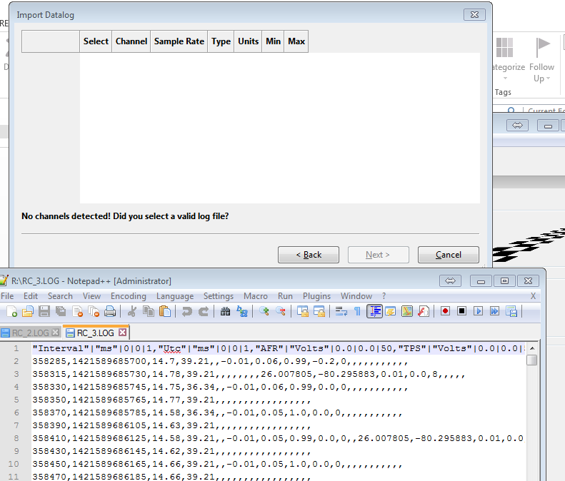

Trying to make sure I am capturing data, so I put my SD card in and tried to import the datalog, but RaceAnalyzer 1.1.15 isn't having it.
Am I missing something?

"Should" being the key word here. That is why I attached the screenshot of RaceAnalyzer saying it didn't like the data shown in Notepad++ right below it, hoping someone could tell me if it looks like something is amiss.

Looks like v2 firmware exports more subfields per data item..
ver 2.7.6 logfile partial header
Code: Select all
"Interval"|"ms"|0|0|1,"Utc"|"ms"|0|0|1,"Battery"|"Volts"|0.0|10.0|1,"AccelX"|"G"|0.0|0.0|10,"AccelY"|"G"|0.0|0.0|10,
old version logfile partial header
Code: Select all
"Battery"|"Volts"|1,"AccelX"|"G"|25,"AccelY"|"G"|25,"AccelZ"|"G"|25,
not just the additional columns INTERVAL and UTC (new timestamp related fields) but more pipe-delimited datapoints - looks like the format is now name|units|min|max|rate so there are more fields to parse, for either GEMS conversion or Race Analyzer. I'm also not sure how I configured my logging for a max battery voltage of 10V.. though I've been running it at home on USB power for a while now.

Also looks like it's been that way in src/logger/loggerApi.c since October 11, ver 2.1.0 - "added min/max/precision to streaming API metadata"
Note, RaceAnalyzer not compatible with the V2 log format. The application has been sunset and analysis features are being moved to the new RaceCapture app.
