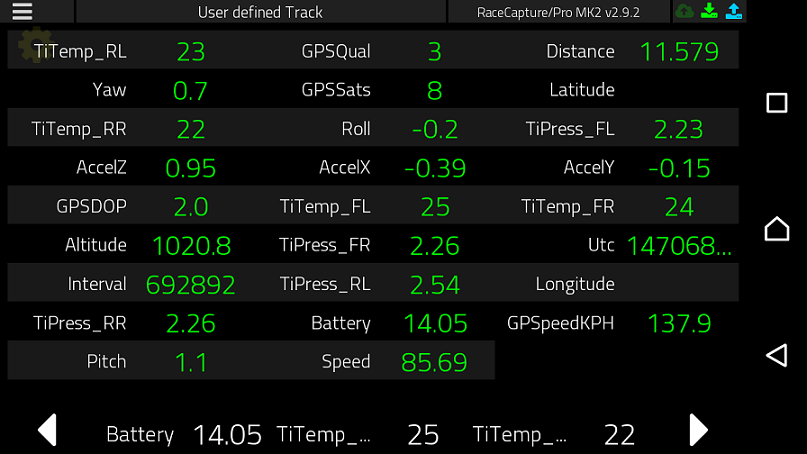

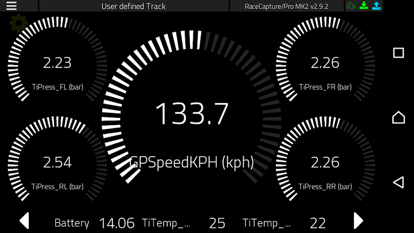

We are actually testing TPMS systems in combination with RaceCapturePro.
Next to some road tests the systems will be further tested under track conditions within the upcoming weeks
...more to come soon!

It's not a system you can buy yet but here are some preliminary infos:
  • 1 Mbit CAN speed (like most motorsport CAN devices),
    CAN 2.0B with 29bit identifier,
    Internal or external sensors, both with higher refresh rates than the average sensors commercially available,
    Quick sensor learning with dedicated CAN commands, which will be generated by the RCP script
If you are interested then drop me a pm with your email for further details.
