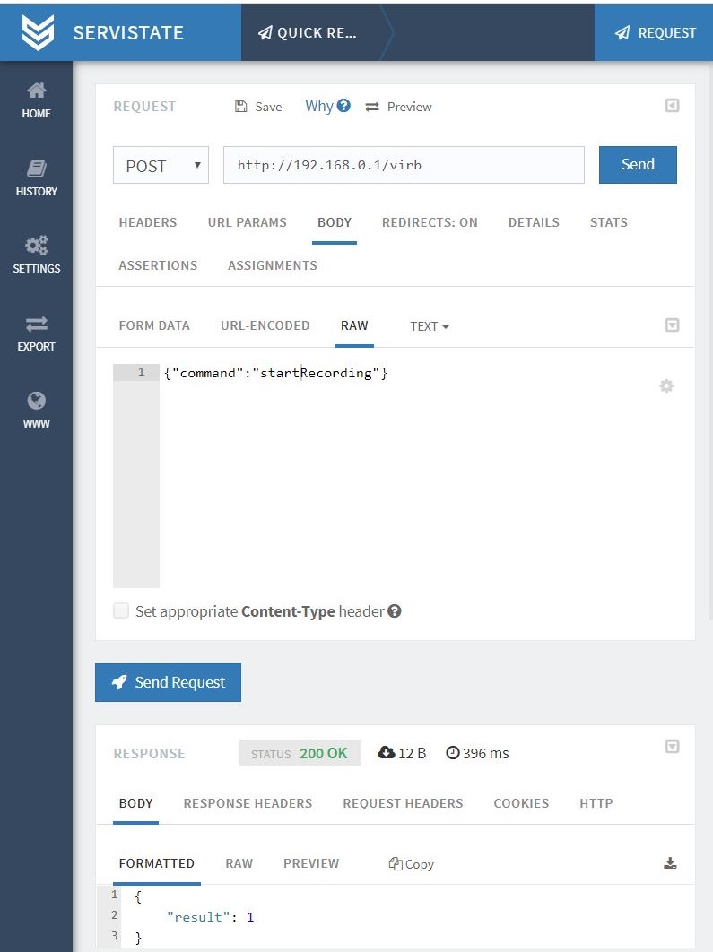

How can we send an HTTP POST request to connected WiFi client via Lua Script?
So if I want to say use Chrome extension SERVISTATE to send commands to a WiFi client via POST request, how do we do it?

- startRecording.JPG (113.94 KiB) Viewed 18561 times

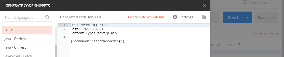

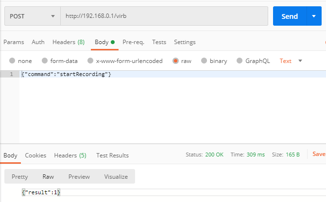

The Postman program was super helpful to figuring this out. The easy part is simply sending the command via the Postman command line.
What was really helpful was using the Postman feature to view the "code"
Then as @brentp suggested, I Googled "esp8266 http post request at command" Careful with the results, because some of them pertain to GET command, not POST command. (For reference, GET is what the GoPro Hero uses.)

- Garmin Virb startRecording command via Postman
- startRecording-command.PNG (15.58 KiB) Viewed 18545 times
- Garmin Virb startRecording HTTP code via Postman
- startRecording-code.PNG (17.09 KiB) Viewed 18545 times
