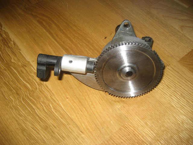

hi, just adding to this older thread, i have fitted a 72-2 wheel in the case of the old distributor. the wheel is a slice of gearstock which is 36mm in daimeter. the teeth are 1mm thick, separated by <1mm, and the valley between them is <1mm deep. i used a vr sensor from a 90s mazda rx7 crank angle sensor.
the car is up an running today. it certainly revs out high enough, but i have not put that to any rigorous test. still having an issue with missing under acceleration, which could in theory be to do with poor signal quality due the tiny teeth. i have, however, only driven the newly fitted car about 4km. these parts were suggested to me by someone who had successfully used exactly the same parts.
so, bottom line.. yes 72-2 wheels in the dizzy can be done, and they can be very small indeed.

But... since last I tried to manufacture the trigger wheel myself. It is 90mm in diameter. I gave up because of poor tools and teeth varying too much in size and position when I tried.
But a collegue at work has a friend that works as a watchmaker. And he has now been put to the task !
So I hope to have that part quite soon. Everything else has been installed in the car.

Yes, the thought has crossed my mind about a cover. Haven't really done anything about it yet. (Haven't had spark yet either....)
I was in contact with trigger-wheels.com, to see if they would manufacture a 72-2 wheel. But it was to expensive for them to do.
This wheel was done by an enginer who manufactures parts for helicopters. So you could say he had the tools for the job !
Your solution with the smaller wheel - I would rather have done that. But when I had mine done, I wasn't sure that the size of such a small wheel and small teeth would work with the sensor. But were I to do it again - I think I'd gone your route.
(or maybe an upgrade of this dizzy later.....)
