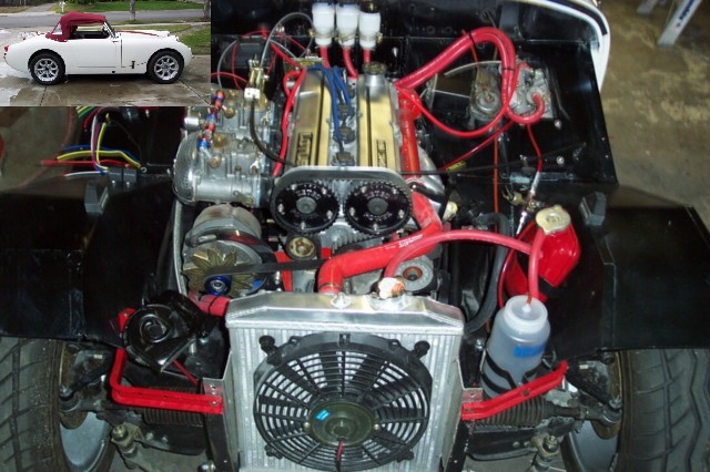

You should stick with the British cars
Mine is a 1959 austin healey sprite with a ford zetec engine (megajolted)
I had a 73 Tii (I don't think I would have ever tried to megajolt it though). Those cars are notorious for wiring shorts, especially at the fuse box. I pull the power form under the steering column from one of the wires that comes out from the switch when power is on.
rod h.
- Engine-Bugeye Inset.jpg (88.75 KiB) Viewed 15338 times
