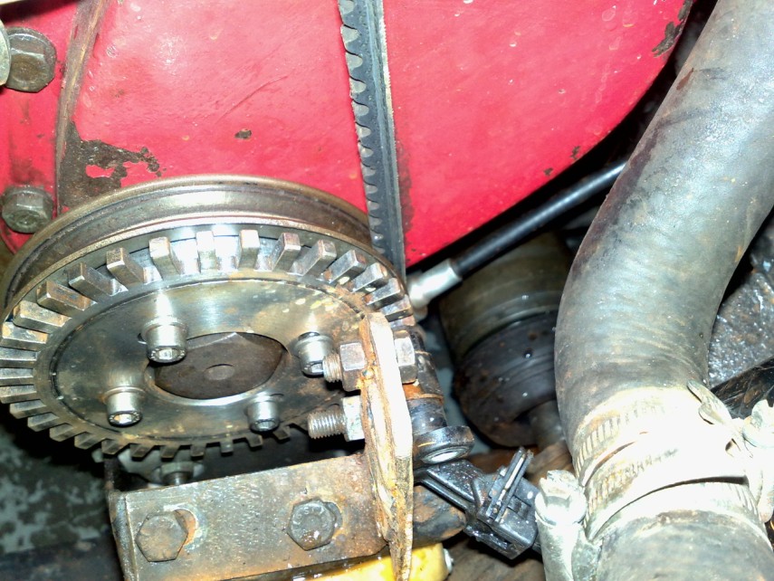

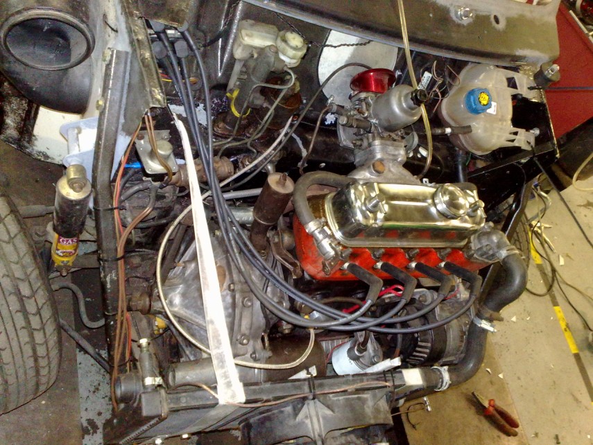

1275 A-Series
Vehicle: Austin Mini
Year: 1989
Trigger Wheel Source: Made at local engineering shop for £70. Teeth are 10mm deep as VR sensor is located at 90 degs to wheel. Used a 998 pulley without damper. Rivets ground out and holes threaded. Triggerwheel is mounted with 4 bolts. 10 deg adjustment in triggerwheel. Triggerwheel diameter equals the pully diameter.
VR Sensor Source: Ford Ka
VR Location/mounting bracket: Radiator now mounted at the front and used the old radiator mount bracket to form a bracket to now hold the VR sensor as in picture. Strap holds Vr sensor. Vr sensor can only be adjusted in distance from wheel.
COP/Coil Pack and Ignition Leads: Believed to be off an old Ford Fiesta with a flat bottom so easily located on bulkhead. Leads were for a Fiesta from an auto factors.
Year: 1989
- Shows Coil Pack top left to spark plugs inc leads.
- 18092008100 (855 x 642).jpg (190.27 KiB) Viewed 78058 times
- Shows Triggerwheel and VR Location
- 17102008251 (855 x 642).jpg (164.53 KiB) Viewed 78058 times

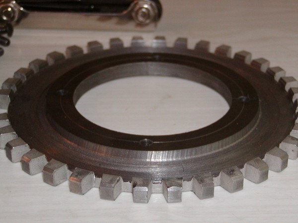

Re: Triger Wheel Design
Subject: Engine Type and size. A-series 1330
Vehicle: Midas Gold Convertible
Year: Donor 1986, kit build 1996
Trigger Wheel Source: Trigger Wheels laser cut wheel, face of pulley machined down to interference fit before final welding.
VR Sensor Source: Mk4 Escort 1.4 OHV
VR Location/mounting bracket: Post mounted onto timing chain cover, home made on lathe.
COP/Coil Pack and Ignition Leads: Coil, Ford EDIS4 System. Leads, Ford Fiesta Motorsport
The coil pack is mounted on the inner wing completely out of sight unfortunately.

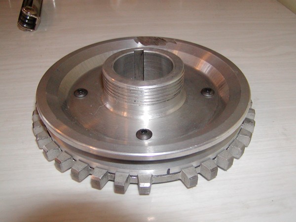

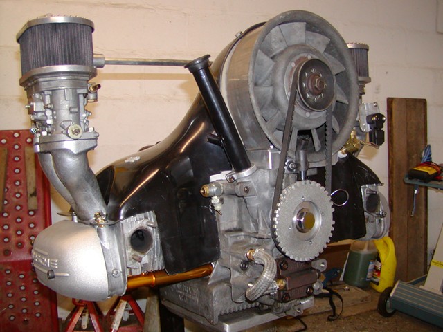

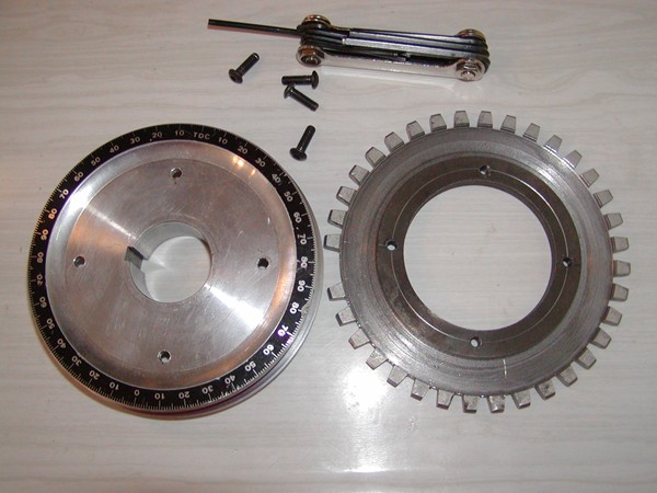

warning for rubber damping on timing pulleys
I was out driving the other day and the car was running great! untill i heard lots of misfires and the engine would not run. some pulleys on cars have like a rubber centre,kind of a shock absorbing material,this failed and and all timing was lost.just wanted to share this info.luckally no other damaged occured.lee
Motor:VW type1 2165cc
Car:Porsche 550 Spyder replica
Year:1956/2002
Trigger source: Ford Escort 1990
VR source: same
Coilpack:Accel aftermarket Ford replacement
Wires:stock Ford Escort with VW/Bosch airseals added to plug boots
TPS:Ford Escort also
Distributor plug: NEW oil filler!
Rubber center removed, wheel is thinned and step cut to fit 5" dry sump aftermarket pulley
VR spaced and affixed to custom aluminum stand for Porsche 911 fan/alternator assembly

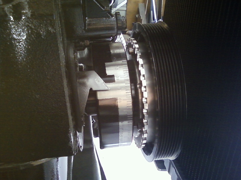

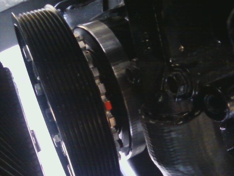

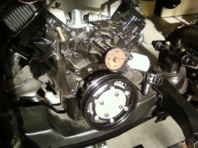

Trigger wheel ford Cleveland V8
Alluminium stock turnrd down to hold TW and 8 groove pulley. Pickup not mounted yet but tooth marked with red dot shows where it has to go, so the two water pump snout bolts look like they have another job comming up.

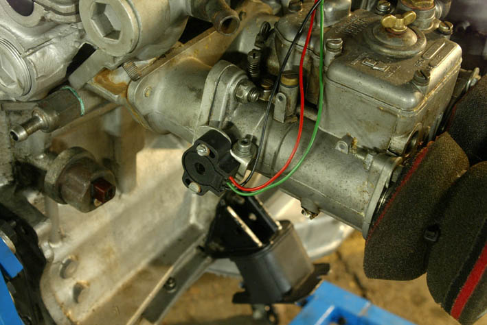

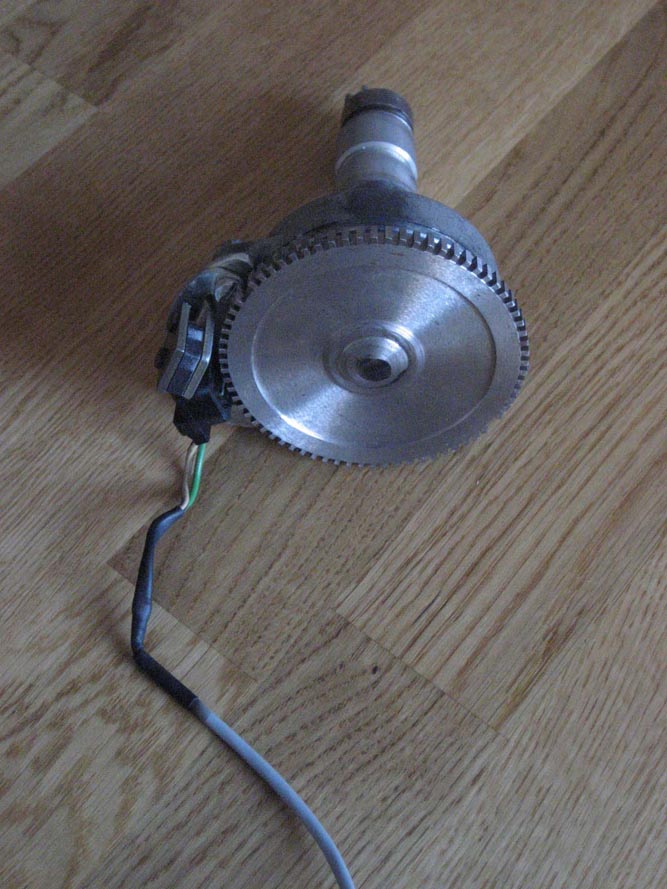

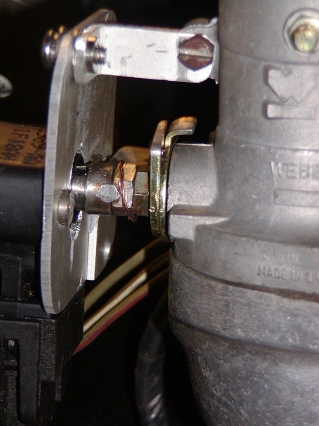

1970 Alfa Romeo Junior Zagato
Subject: Alfa Romeo NORD engine 4 cyl, 1750cc - modified. Race-setup with new cams, enlarged inntake valves, high-compression pistons, 2x45 Webers, non-stock exhaust manifold
Vehicle: Alfa Romeo Junior Zagato
Year: 1970
Trigger Wheel Source: home made (by helicopter parts supplier), mounted on rebuilt dizzy. 72-2 toothed
VR Sensor Source: Mazda RX7 Crank Angel Sensor (2 in each unit)
VR Location/mounting bracket: On rebuilt dizzy
COP/Coil Pack and Ignition Leads: From Triggerwheels.com, Carmodel unknown. Ignition leads from kit with EDIS-unit, leads, Coil and sensor.
Year: 1970
Link to info on the car:
http://www.autosportlabs.org/viewtopic. ... 4551#14551
- Rebuilt dizzy
- dizzy4_sized.jpg (122.04 KiB) Viewed 72401 times
- TP-sensor on Webers
- 7EBA8563_sized.jpg (87.51 KiB) Viewed 72401 times

My installation on a 440 MoPar (same for 350, 361, 383, 413, and 426 wedge engines, but not sure about 426 Hemi's) is on the site here at the URL below.
Yeah, the car is a Jensen, but the engine is a big-block MoPar.
http://www.autosportlabs.org/viewtopic.php?t=3206
...Bob
