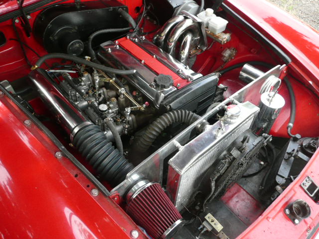

Toyota 4AG 16V swap into my 1970 MGB GT
Toyota T-50 5 speed trans.
Narrowed GTS disc brake rear axle 4.3 A 4.77 lsd 5 link comming soon
Dellorto 40 side drafts on HKS 8 port intake
Stainless turbo under mount header gets exhaust around steering (just)
GZE block 10.3 comp pistons
adjustable cam gears
212mm lightened fly wheel with ACT street comp plate and disc.
EDIS4 with MJL (of course)
Alum rad and custom alum core support.
Stainless cold air intake /silencer
Ignition is is concealed under the carbs and plug wires routed under cam valley plate.
Some mods include deleted side markers, back up lights and MG hood bulge.

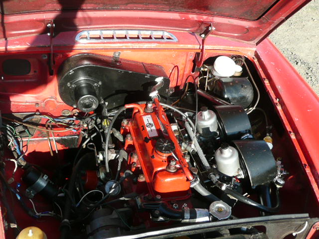

Before
Before

hey i know i know super old thread... im doing, well, basically the same thing...getting the motor put together on the stand right now. how did you do the oil pan? is it set way far back to clear the subframe, notched subframe, or a custom pan/pickup tube?
kclm9803
Posts: 14
Joined: Sat Aug 08, 2009 4:20 am
Post by kclm9803 »
Gotta cut the cross member, unless you want to lose the heater and or chop the firewall like the V8 guys do.
A piece of 3" angle 8" long, boxed and welded in and your good to go with the stock pan set up. Not the prettiest welding but it's out of sight.
Nice looking motor the EDIS is the best upgrade I made the MJ is great. Tweak cam timing without fiddling with ign.
Had to do the alt on the drivers side after trying and trying on the pass side (plumbing gets tough)
Drop me an email if need more info on the swap. When I did it I couldn't find any one that had done one.
It's working great but the 3.9 MG axle is too high, I'm building a narrowed GTS axle with 4.30 I might have to go to 4.56 but I'll try the 4.3 first.
I have an extra GTS drive line if you need one.
KC [email protected]
