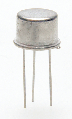

T2 transistor - when I look up 2N2222 I get one that looks like the enclosed image. Judging from the picture does it look correct - and/or what should I be looking for in the transistor.

We use the plastic bodied 2n2222- you can see the datasheet here:
http://www.mouser.com/onsemiconductor
The metal can will work, you simply need to match up the leads for base, emitter and collector.
