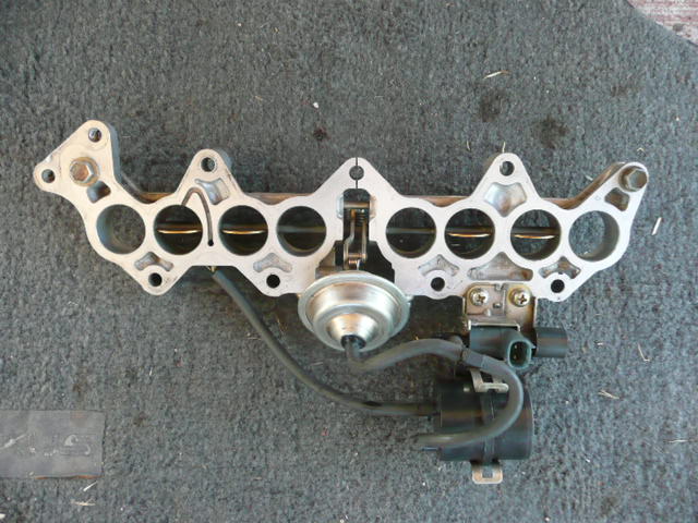

Here is what I have going on.
I am running a Toyota Variable Induction system (T-VIS)
The way it works is the the solenoid is energized (closed) at all RPMs below the set switch point.
When the preset RPM is reached the power to solenoid is switched off and it opens thus opening the induction control.
I have the user output set to inverted and 3800 RPM, so if I am not mistaken I should have a closed curcit until 3800
So why if it's a load issue is it a problem only when the load is absent?
You can see the sol. connection in the pic, the big black thing is an accumulator, the solenoid is tiny.

Hello,
Excellent tips so far. NITROPIXIE and DannyP's analysis is spot on. As it turns out we have actually controlled this exact device via a user output on our turbocharged 4AGE. The standard user output should be able to drive the solenoid valve directly.
How are you feeding the power to the solenoid valve, EDIS module and megajolt? A common circuit, or separate? You may also check ground connection- make sure you have a good ground for the EDIS module and megajolt. make sure everything is grouded to a center location ("Star" grounding scheme).
Thanks Brent for looking at this thread. I'm powering the T-VIS EDIS and Megajolt from a separate power sources with all being grounded at one point. When you ran the T-VIS unit on the turbo 4AG did you use an inverted user output?
I suspect it's a ground issue, glad to hear I don't need a relay.
