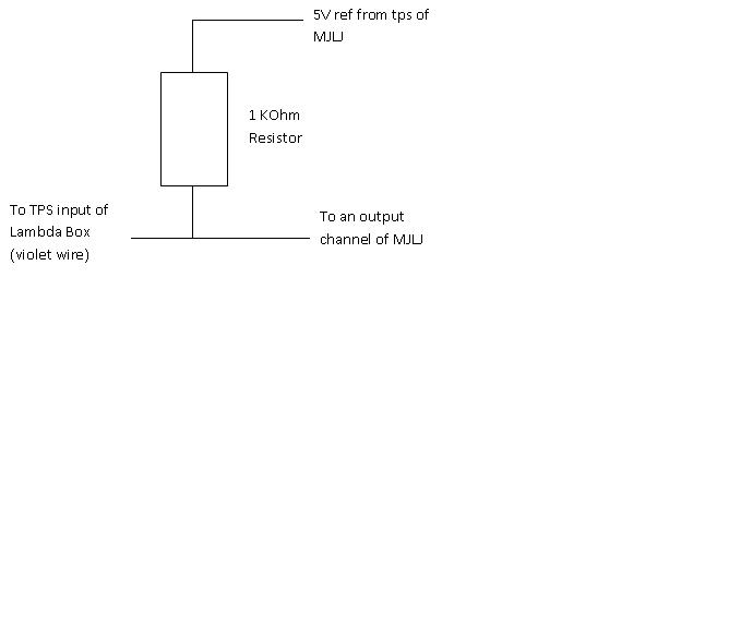

Could I use the Megajolt outputs in some way to fool the LPG control box into thinking that it is seeing a TPS in the closed/idle position? I was thinking i could take an output triggered at say <800rpm (750rpm is the Land-rover specified idle speed)...
I don't see why you can't use the map sensor output as an indication but without the instruction manual in front of me obviously i can't say for sure. The outputs of megajolt are digital, on or off, so could switch at a differing map pressure if programmed to do so.
Hope this gives you some ideas. If you can find an electronic manual somewhere ic an try to help you work it out.

Correct a tps is just a potentiomoeter. It has 3 connections going to it which are usually a very steady 5v, 0v and output which can vary between 0 and 5v obviously.
Your Map sensor in megajolt works on a similar basis and has 3 connections, altough there are 5 pins on it only 3 are used with megajolt and its senses vacuum in the manifold.
I'm only guessing when i say this but you may be able to setup a threshold voltage on your lpg ecu, at which point it will go into idle mode.
If you can follow this, the megajolt units outputs only ground when they are activated or float (not connected to anything) and don't produce an output voltage. If you add a pull up resistor then you can add +v and 0v. When you program megajolt on the configuration page, select options, then on one of the outputs select the load option, then input a load value at idle. I'm not sure if you want normal or invert output mode. Then you should be able to control the idle on your lpg through megajolt.
If you need more help and a circuit diagram then i'm pretty sure i can help you out. But i do need to see your lpg instruction so i can get a better idea but i believe something is very possible here.

The TPS threshold is adjustable on the Lambda box, so does this mean that i can just set the MJ to output in a specific scenario and then adjust the box to suit?
So if i understand correctly, i connect the MJ to the lambda box TPS input, and the Tee off of that to +12V with a resistor inline? I'm afraid my last qualification in electronics was a GCSE over 10 years ago... :oops:

From your description it sounds like you have hit it on the nose. Below should be a diagram of how to wire it up. You should be fine using the 5v reference from the Megajolt as +v. Around a 1 KOhm resistor should be adequate and fairly easy to get hold of. I think most TPS's are around 2 KOhm so what ever you can find bewteen these should be ideal but isn't that important. So long as it isn't Mega Ohms
As to whether you want normal or inverted outputs, the normal load output is activated (grounded) when it goes above the set threshold. We want it to activate below a set load threshold so that it is grounded. Vacuum is around 102KPa at wide open throttle and around 35KPa at idle. We want it to activate say below 37KPa so we will need to invert the outputs in the software.
For information, the TPS sensor normally has 5v from an ecu as a reference and the output voltage increases as the throttle opens more on most cars.
You just need to set the Lambda Box to switch at anywhere between 0.1v and 4.9v, as Megajolt is now going to control the switching of the idle. To get the right point of switching for you will be a matter of trial and error but i suggest a value just above your normal idle value to start with.

Sorry, just realised i hadnt posted back here with results- the open loop trigger is working, currently set to go open loop at <900rpm. It idles at 850rpm...
May try switching this to a MAP based reading as that would reflect a more true TPS situation, i.e. you can have your foot completely off the loud pedal but still be doing a fair few rpm, but on the other hand it works brilliantly the way it is so may just leave it.
