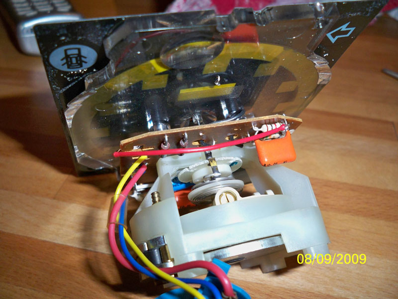

If your AX GTI is anything like my 205, bearing in mind Citroen and Peugeot share technology, you might have to modify your tacho to accept the 12v pulse from the Megajolt.
This has been mentioned in another post (I am cheap and cheerful), but I removed the first two components in my tacho a resistor and a capacitor i think, and bypassed them, done this on three 205 gti tachos and they all work with the Megajolt 12v pulse. I decided to take a photo of the one I did this week and tested - worked fine.
I suggest you get a set of spare ax gti clocks and have a go at modding them, if you have MJ installed on your car you could try the VRSSIM to test it all - I always use it for testing Megajolt Installs.
