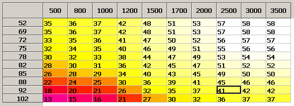

The car (1963 Triumph Spitfire) has a factory max advance of 39deg+-4 (zero vacuum) to 59deg+-2 (highest vacuum). The Megajolt has a maximum advance of 59deg. If the engine modifications call for a higher advance, could the global controller trigger offset be set to a plus value of say +3 and give a real advance 62deg, or is the cut off hard set at 59deg without tricking it by moving the sensor a couple of degrees?
The other question, and currently most confusing to me is about idle advance. As the carbs on this car originally used a ported vacuum on the carbs the vacuum at idle was full, yet the ignition timing was 15deg. As the throttle was opened, the vacuum was registered with the distributor and the timing was handled from there. Now that the vacuum is taken from the manifold, I have tried to simulate this by setting the idle rpm range to 15deg across the Kpa range, i.e all of 800rpm Kpa range is 15deg. Should I be doing this, or should I really allow the megajolt to read the vacuum and change the ignition timing. i.e 35deg advance at idle. There is no pinking at this advance, but I'm not sure whether I should keep the ported vacuum simulation set up, or just leave the megajolt to do its thing. See the attached screenshots to see what I mean.
To explain the kpa and rpm range values here. the kpa values are taken from the original factory service manuals and the advance is all in at 3000rpm which is why the range stops at 3500rpm.
Thanks for any input you might have on this, especially the idle advance values.
I've posted the factory specs along with the initial maps created from them and my current map file in the map library. http://www.autosportlabs.org/viewtopic.php?t=2631

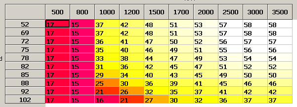

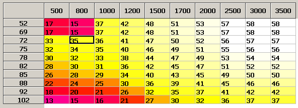

- This is how I have it currently. At idle and it's highest (non overun) vacuum, advance is set to 15 degrees, but jumps to much higher values when off idle.
- current.png (7.7 KiB) Viewed 12864 times
- This is set to 15deg across the Kpa range at idle rpm. Slightly higher at lower rpm to keep it stable if idle rpms dip a little
- full.png (7.26 KiB) Viewed 12864 times
- This is how it would be on a distributor if the vacuum was originally taken from the manifold rather than using the original spec ported vacuum point.
- none.png (7.64 KiB) Viewed 12864 times

Hey, nice to keep us updated.
I suppose in the grand scheme of things it doesn't matter so much the amount of vacuum you do have as you can always adjust the vacuum axis to suit the engine, and so isn't a problem with the megajolt. Just keep the setting relative to your engine by keeping the same tables but changing the load axis to suit yours. 54 KPA is about 16 inmg so is within the ball park figure.
I'm not too sure about changing the values of the trigger off set to gain more advance, but you could physically offset the trigger wheel to gain extra advance if you needed to and alter the advance table to suit the correct advance required. I personally really don't think you should need this much advance. My A series has a maximum of 36-38 degrees advance at the top end.
My understanding is that the vacuum advance on cars is to improve the fuel efficency of an engine at the lower end of the rev range. All modern engines have a manifold vacuum port to which they recieve information of the engines load in order to give the correct amount of advance. Advance increases with rpm and an increase of load (less vacuum).
Also the reason for advance is that an fuel air mixture requires a set amount of time to burn before it creates it's maximum kinetic energy. The more air fuel mixture within the engine (acceleration) the longer it takes to get to this max kinetic energy point so more advance is required to get the maximum performance. So when idling not much air fuel mixture is used so a small amount of advance is required, when accelerating hard alot of air fuel mixture is entering the cylinders so alot more advance is required.
There will be no pinking with 35 degrees advance at idle as there is little/no load, but then at this advance your engine will be running hotter plus it's not good for the piston rings and you run the risk of them being fried with usage like this. Basically what happens is that the air fuel mix has reached its maximum kinetic energy while the piston is still coming up and i'm sure as you can appreciate this is not a good situation.
I believe what you have done here is incorrect and a continuous gradient is what is required, but an exact amount of advance is not required especially in low load areas like these, so it shouldn't make too much difference anyway.
