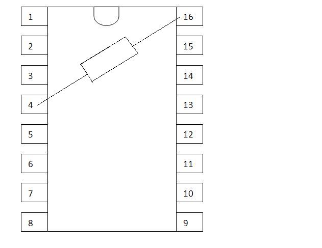

To check if the oscillator is drawing alot of power you could use a standard 1000 Ohm resistor instead of the processor chip. Here you would take the processor chip out of its socket and run a resistor from where pin 4 of processor chip would be to pin 16. I have included a diagram. Then test then current again.
From what you have said i would expect the processor chip to be at fault but you never know.

I did that , and I saw 40mA , with and without resistor . I measured 180 Ohm on board power supply to processor ( gnd and 5v ) , and 28 Ohm on same processor pins ( 1 & 16). I dont know much about electronic , but my verdict is that processor has gone .
