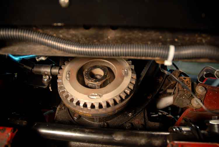

I was going to have my shop mount the wheel on the back side of the pulley, with a sleeve to
hover it away from the pulley. My shop guy explained the cost factor and i said lets put it on the front.
So he put a flat spot on the front pulley and tack welded it. Then spun the pulley with trigger wheel
to take out any high spots. I can run the VR at 10 thousands out. (total shop, 106.00)
After i brought it home, i said how i am going to get the belt off? I know a lot of other installs
put it on the front and i have never changed a belt on the road. However i do carry a rather large
bag of tools......
Check out the photo for my where is Waldo Moment. I didn't notice this new problem till i shot the photo
EDSI-4 Spitfire 008b.jpg (45.32 KiB) Viewed 4319 times
