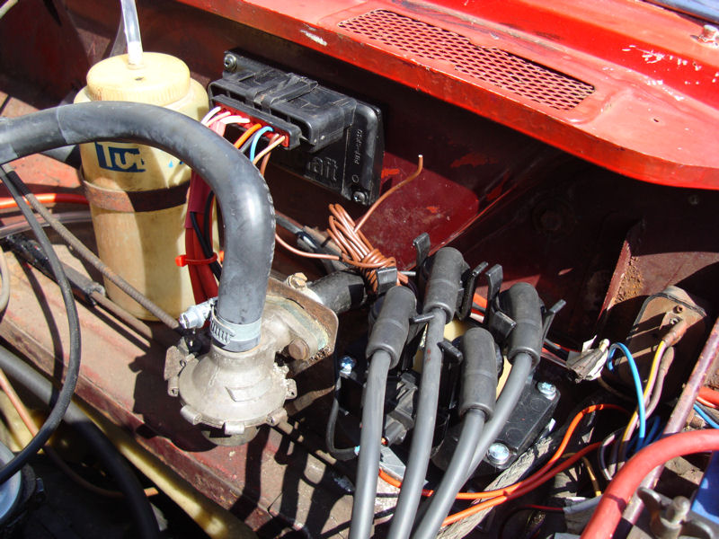

- EDIS on bulkhead and coilpack on existing coil fixing holes
- Jolt1.JPG (157.96 KiB) Viewed 17248 times

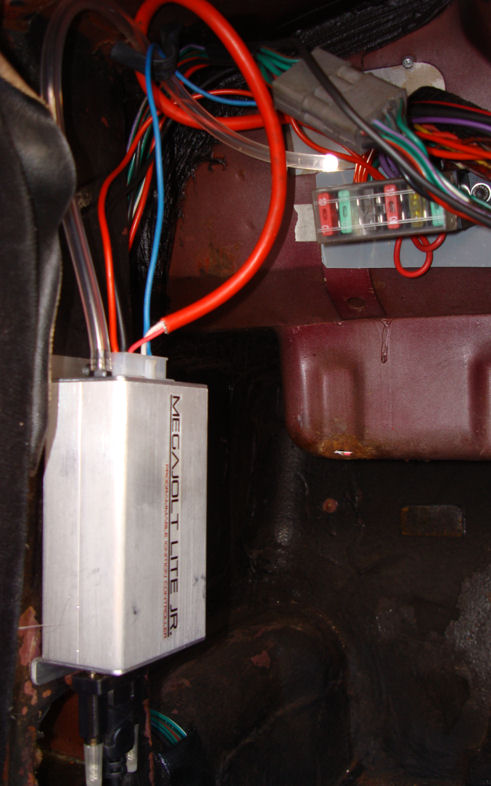

- Megajolt under dash on A pillar - new blade type fusebox fitted.
- jolt2.JPG (88.8 KiB) Viewed 17248 times

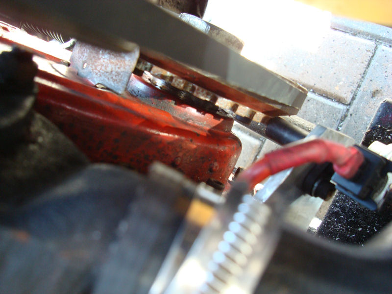

- Crank sensor and trigger wheel on back of pulley
- jolt3.JPG (102.4 KiB) Viewed 17248 times

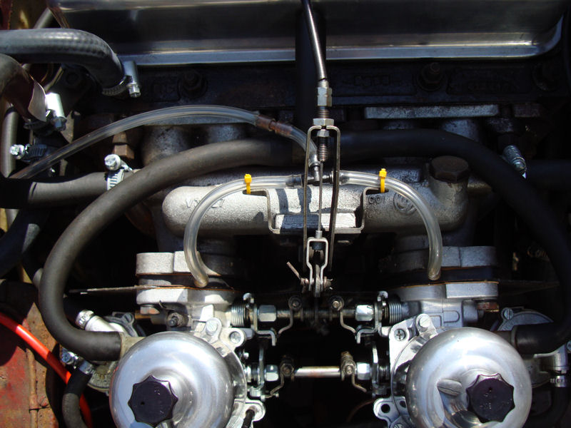

- MAP take offs using adaptor plates between carbs and manifold.
- Jolt4.jpg (115.16 KiB) Viewed 17247 times

One thing i would suggest on your 3rd picture is that you could lengthen the hoses from your carbs to the T piece. Is that a restriction in the pipe going to the MAP sensor??? It would probably be more beneficial to utilise 2 of these, one for each side of the T-piece on each carb branch and then a small reservoir to the MAP sensor, which will help smooth out the vacuum signal some more. What we are trying to do is make it harder for the air to be robbed from carb to carb and easier from carb to MAP sensor.

Thanks for your comments. Yes that is a restrictor in the take-off, it's actually a 0.6mm mig welding tip, I've now taken it out and gettting a very stable reading, it was a bit twitchy before that - the take-off adaptors have a very small hole in them anyway (about 0.5mm same as the standard vaccuum take-off that used to go to the distributor).Doesn't seem to be much robbing between the carbs but they are pretty accurately balanced now anyway. I think what is happening is that the take offs are acting as restrictors and the fairly long pipe run to the megajolt is acting as resevoir/damper. Might add a small reservoir and see if it makes any difference.

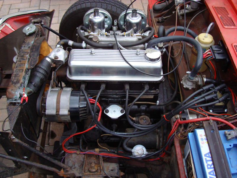

Another picture showing blanking plate where distributor was, the small screw in the middle secures a 10mm thick disc on the back that stops the oil pump drive jumping out of engagement.
The bit with the wires on rad top hose connection is a thermal switch that will be used to control an electric fan, a la Nitropixies suggestion, only testing at moment hence grotty wiring. Slight snag with the fan I have, it came off a Rover 200 and is complete with cowling that is a perfect match for the size of the rad. unfortunately it has to go on front of radiator and it sucks air through from the engine side so not sure how welll it will work.
- Distributor side of engine
- Jolt10.jpg (141.44 KiB) Viewed 17163 times
