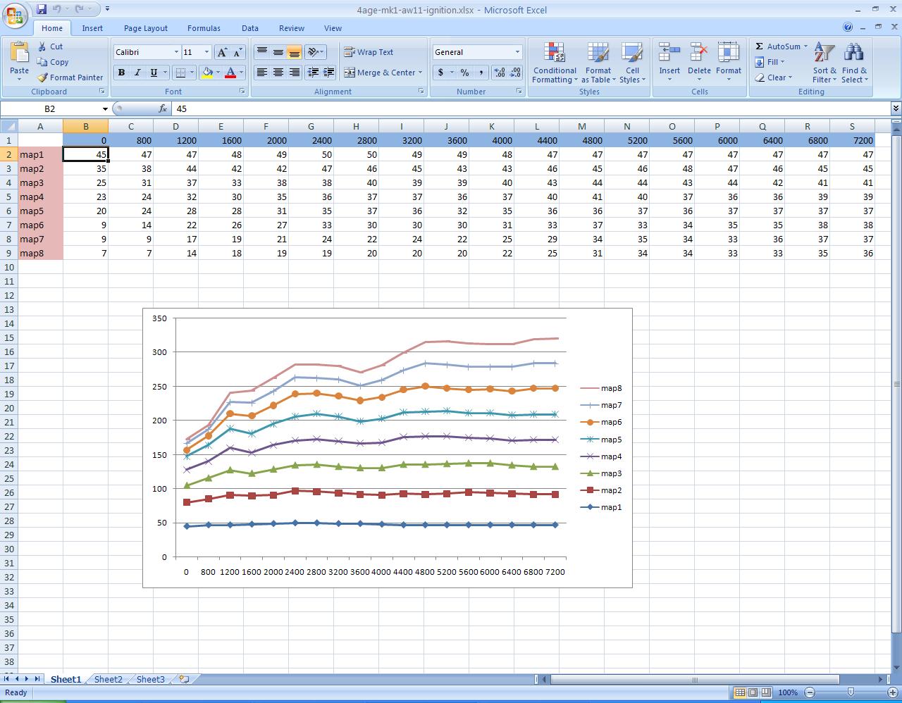

my reasoning is actually pretty simple minded. i've mapped out as best i can the aw11 ecu ignition table from jeremy ross' work and uses 18 columns of rpm resolution. i wanted to emulate it and tweak the timing table for my hi-comp setup.
the timing tables show interesting dips at various spots with slight differences among the 8 map lines.

according to Jeremy Ross' findings, the AW11 ecu DOES interpolate between the various ignition maps based on several conditions received from its sensors.brentp wrote:Interesting. with the 32 bit processor and ample RAM / Flash the limit of the ignition map is more of a human management issue (so many numbers to edit). I think some software tools to edit / smooth / manage ranges of the the map could help alleviate that. Also, I wonder if the AW11 ECU does interpolation between bins?
i've attached an excel file of the aw11 ignition map based on the extracted info from the factory MAP ecu.
- 4AGE-AW11-IGNT.JPG (199.76 KiB) Viewed 18715 times
