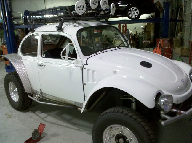

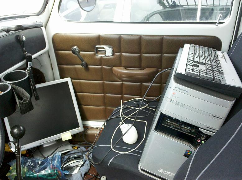

Another one, this one has a fresh install and just starting to play with the maps. Check my "Lap Top".
- 25%.jpg (90.26 KiB) Viewed 25416 times
- 30%.jpg (112.57 KiB) Viewed 25416 times
- IMG_20110419_131156 40%.jpg (147.94 KiB) Viewed 25417 times

datalogging
its easy, I just go in circles! Actually I have a 5K watt inverter mounted under the passenger seat. You should see what I bring along for a cooler!

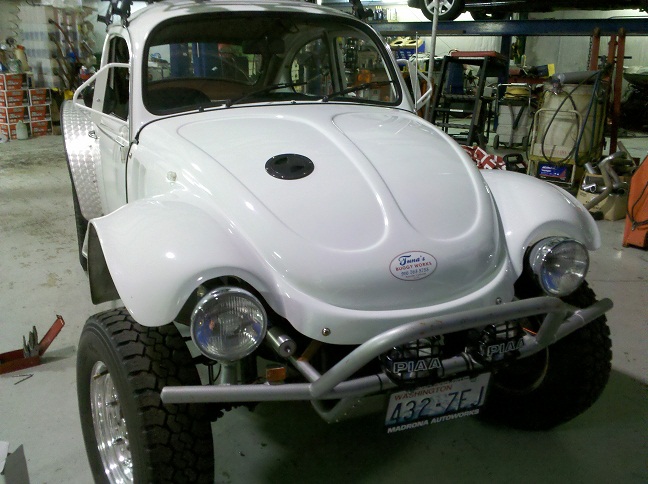

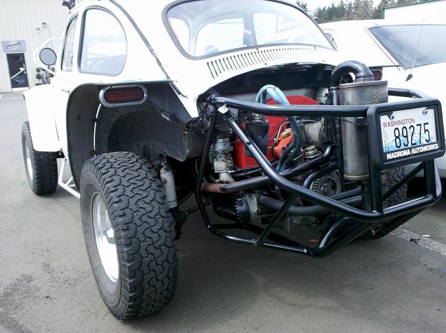

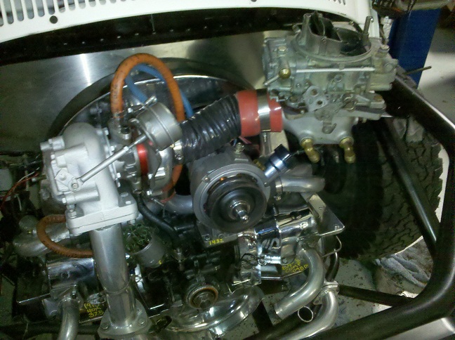

I love my baja, I have big plans for the suspension. I basically want Trophy Truck like suspension. Right now I am upgrading the powerplant since I have got the MegaJolt working. It is a 1915 with nice heads, crank, pistons etc............. with a T-3 turbo. I am guessing between 170-200 hp. The car weighs 1700lbs. Here are some pics for your viewing pleasure.

I should have the turbo engime running in the next couple days. Just finished the exhaust system and fabricated a throttle cable system to work with the transverse mounted 4 barrell. Just a couple more hurdles and im drivung

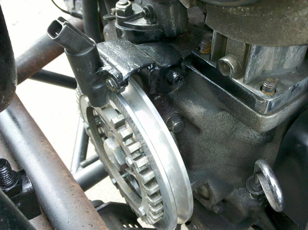

Yes, a type1 from back in 2002. I have over 20,000 miles on it, going very strong still. No signs of less power yet, but I do realize a top end refresh is in order by 30,000, as it dyno-ed at almost 180 hp. Jake built me a really nice motor. The Megajolt really helped a lot with more power, better drivability and torque. I cranked the advance and am on my 20th revision of my original map, which was centrifugal(009) only copy. I logged the advance every 500 rpm, copied that, and developed from there. I use a TPS on one of my Webers.
