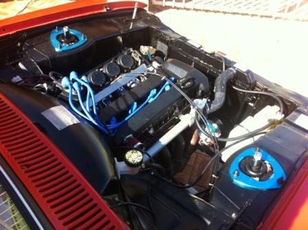

Thought I would post up my Megajolt project.
'73 Mk1 2 door Escort
2007 2.0 Duratec on Carbs (ZX6R)

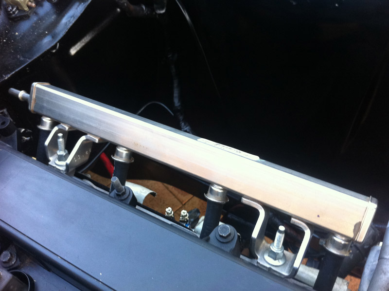

She's up and running but I cant do a full tune yet until I get some Rego on her. For those interested, the vacuum 'balancer' is the old fuel injection rail. I just replaced the injectors with some fuel line. It works really well, it is not as laggy as I thought it may be, and it gives nice smooth MAP values to the unit.
Vacuum balancer
Vacuum balancer
Running stage
Running stage

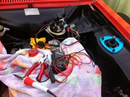

The wiring nightmare begins
