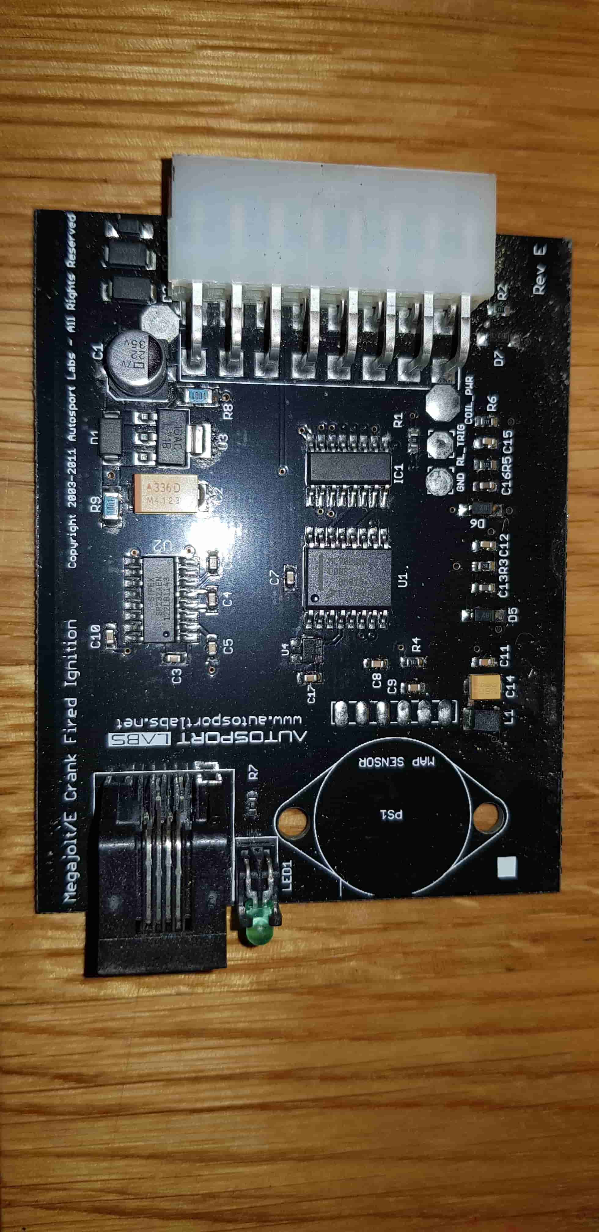

I have a TPS board, can i add this part to this board to have a MAP version. I have a Spitfire Mk IV so MAP is my preferred option.
MegaJolt MOBO
MegaJolt MOBO
Yes. You just need to install the MPX4250 AP with the port facing down (towards the board). Secure the MAP sensor with a small zip tie or bolts.
The port will extend through a hole that needs to be drilled in the end plate of the unit.
