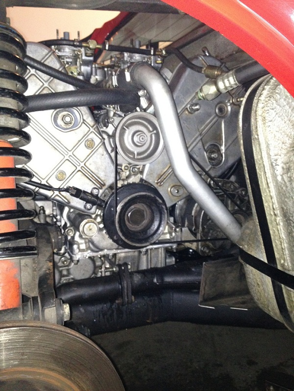

rattling can sound in engine over 4k rpm
I'm baffled by this. The engine runs fine and still makes very good power, and the MJ software is showing the engine is running perfectly normal, but above 4k rpm there is a rattling can sound inside the engine that almost sounds like detonation. Again, the software says it's running fine at all rpm. I know it's not detonation as I have dialed the timing way back to check that hypothesis only to find the rattling was still ever present. The engine never did this until very recently, and I've put about 800 miles on the system and engine so far (new engine)
here's what I've troubleshot so far:
-all wiring double checked
-sensor positioning measured, remeasured, tightened, gap to trigger wheel checked and is .019-.024 (no stone unturned with this one) with a .005 runout
-new magnecor wires
-checked coils
-plugs
-checked timing with a timing light (it's fine)
-leakdown test on each cylinder (less than 3%, new engine with gapless rings)
what the hell is this?? It *only* happens above 4k.

brentp wrote:That is very strange. We've never had a report of rattling before! Can you swap back to the old distributor setup, just as a test, to see if the rattling occurs there as well?
Can you hear the rattling if the system is running on EDIS-8 alone (megajolt disconnected) ?
I will give that a shot. Thanks Brent
Ferraripilot
- Posts: 26
- Joined: Mon May 07, 2012 5:05 pm
Ran engine in limp mode with EDIS8 only. It ran well until about 4k rpm when it started to misfire, lots of popping etc. It also made the rattling sound, but the sound was not as present.
I pulled the thick aluminum cam belt cover which I have the VR sensor attached to and made sure it was locked down tight as can be, which it is. I also put a buffer of very hard gasket-like material between the sensor and the aluminum cover it is bolted to which should assist in vibration dampening to the sensor.
I have ruled out the aluminum belt cover I have the sensor bolted to providing a frequency which is only making itself known at a certain rpm as this issue has only arisen in the past couple weeks now. I put several hundred miles on the engine with no problems.
Is it possible that the shielded wire I'm running has deteriorated or gone bad in some way causing the erratic signal above a certain rpm? Or has the VR sensor gone bad? I would think it would be one of the two.

brentp wrote:Normally misfires occur due to vibrating sensor brackets, but I see that yours is bolted right to the case. Hm.
Can you put a timing light on the engine with the Megajolt disconnected, and observe what the timing looks like above 4000 RPM?
This is definitely a strange occurance as this is where everyone bolts these sensors to when Ferrari guys go distributorless with these engines. As I said before, since then in an attempt to fix this I removed the sensor and placed a gasket-like material under the sensor to attempt further vibrational dampening but this was to no avail.
I put a timing light on it with EDIS8 only and it showed a steady 10 degrees until around 3900-4k when it started misfiring. I did the same with the MJ and it showed normal advance and operation above 4k but the rattling sound was ever present as was some misfiring. It almost seems as if over 4k rpm the system is constantly cutting in and out recatching itself into somewhat normal operation, but the datalogs look fine.
So what did the ignition advance look like after 4000 RPMs? did the timing jump / look erratic?
If I were personally diagnosing this, my next step would be to put an oscilloscope on the sensor to see what the waveform looks like at varying RPMs. It sounds like to me the EDIS module is losing / re-acquiring sync with the trigger wheel, as you're suggesting. Do you have anyone that can help you with a next step like this?
Also, might be a shot in the dark, but - do you have another EDIS-8 you can swap in, as a test? Also, check all of your power and ground connections. Are you using a star-grounding pattern for everything? including the shield wire for the VR sensor? Are you using resistor or non-resistor plug wires?
