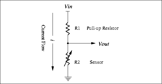

pullup resistors are needed when dealing with passive resistive sensors such as temperature sensors. The pullup resistor makes for a voltage divider, where the pullup resistor is fixed, and the sensor's resistance is variable.
In the diagram below, the vout is what get's fed into the analog input of race capture; Vin connect to the voltage reference - the 5v output of race capture, for instance.

- voltage_divider_sensor.gif (3.4 KiB) Viewed 11947 times

The voltage at the sensor can be calculated as follows (skipping the circuit math and getting straight to the point):
Vsens=Rsens/(Rsens+Rpullup)*Vsupply
Vsens@30degC=1707/(1707+5000)*5=1.27V
Vsens@100degC=187/(187+5000)*5=0.18V
These calculations can be repeated for the entire sensor range according to the sensor specification of resistance versus temperature. Then this sensor linearization curve can be used to transfer the voltage reading to temperature, something like this, degC=[20,30,60,80,100,120],Voltage=[1.67,1.27,0.53,0.30,0.18,0.11].
