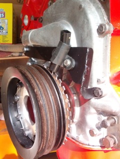

Someone on this board hand-cut teeth into a pulley sheave for use on a SBC. That inspired a solution to my puzzlement in adapting an aftermarket wheel to my IH 196 c.i. four-banger. IH used a hub with stackable pulley arrangement like the Chevy. There are three sheaves possible, so I took a shallow one and turned it around, marked off where there missing tooth would go, fabbed a bracket, and sent the sheave off to Miller's Mule for proper milling of the teeth. His concern was that the metal may be too thin to generate the signal, but I don't think that will be the case. Because the added sheave is one too many for the thickness of the hub's boss, I machined an aluminum cap to pilot into another sheave, then drilled two holes for 1/4" roll pins to keep everything on center and solid. Project is now almost ready for its initial firing![/img]
EDIS 1.jpeg (35.2 KiB) Viewed 10801 times
Thanks for the update! Keep us posted if that trigger wheel works for you - and you should showcase it in the "powered by Megajolt" section!
