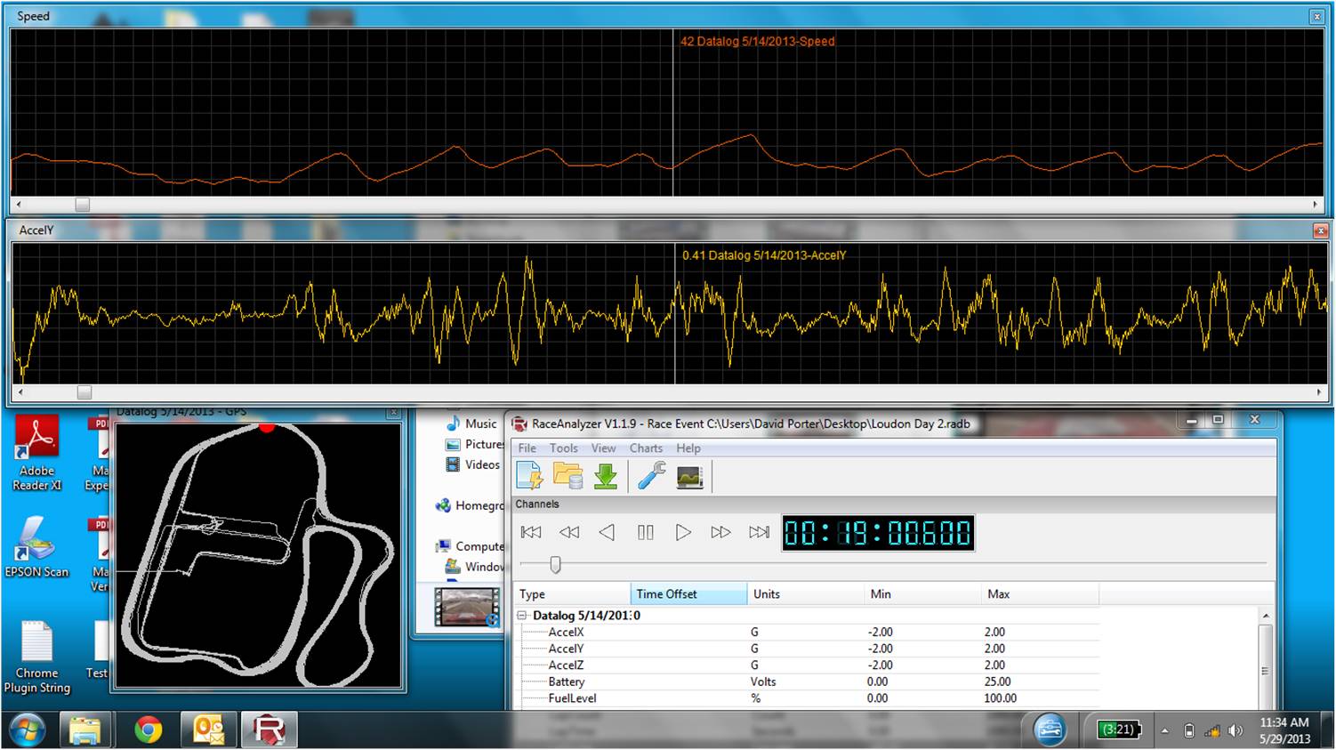

To look further, I looked in Race Analyzer to check out when I was getting acceleration and braking, specifically along the main straight of NHMS, where I should be getting a constant -.3G of forward acceleration (I'm full throttle except for one shift).
I got the attached picture. I'm stumped as to what is going on. I'm most certainly not braking down the main straight, and even if I got my +/- mixed up the data still doesn't look right. Anyone have any ideas?

Thanks for the write-up. What was the logging rate you had configured for the accel channels in that datalog?
I'm wondering if there's something going on with the averaging / smoothing of the accelerometer data.
Could you email me / post a link to your data file so I can take a look at it as well?
Also, try bench testing your unit to observe the accelerometer data as you change the orientation of the unit by hand. What do you observe?

The logging rate is 5Hz for the accelerometers.

The accelerometer smoothing is baffling me a bit. In my mind, averaging over 2 seconds (10 data points) shouldn't matter much when you have longer, sustained corners (many at loudon). Karting or a FSAE track may have big problems with the smoothing, but the worst it can do is dampen small corners.
I did a little analysis trying to back out the delta between the 1st and 11th data point for accelerometers. I noticed that my accelerations were changing at a reasonably high rate when you consider that you are only replacing one data point in ten. In my mind, the theory is:
(A1+A2+A3....+A10)/10 = Data Point 1
(A2+A3+.......+A11)/10 = Data Point 2
Therefore, A1-A11 = 10*(Data Point 1 - Data Point 2)
Now, what does this tell us? In my mind, if I have a maximum forward and rearward acceleration of 1G, then the delta between data points shouldn't ever be more than 0.2 Gs. There will be exceptions, but it should be noise.
You can check out my log file here: https://docs.google.com/file/d/0B9Dlhiz ... sp=sharing
It is big, but not big by modern standards (10MB). However, it is the exact data I was looking at.
dimondjack
- Posts: 101
- Joined: Tue Jan 15, 2013 1:37 pm
My stupid browser won't scroll down when I am making a large post, so I keep having to break them up.
Looking at my data from Karting two weekends ago, 2,000 data points of 13,000 data points have a 10x delta greater than 2Gs, and 1000 of them have a delta greater than 3Gs. In my mind, this just means that the data is noisy, but it does mean that the noise is having a fairly large affect on the data. Does it matter overall? I don't know, but it does mean that heavy braking "noise" is running directly in to heavy acceleration "noise". It would have to seeing as there was a 3G swing over 1 second (I forgot, my karting data I sampled at 10Hz).
Doing the same analysis on some of the Lemons data (with a car that I don't believe can ever get over 1G of braking and 0.5G under throttle). There were 2800 of 20,000 data points with greater than a 3G swing, and 6,000 data points with greater than a 2G swing.
This could be "the luck of the draw", getting noise in one direction and then getting noise in the other direction, but it seems to happen a lot for that.

I was only suggesting to bench test to satisfy any curiosity on your part on what the system logs under varying conditions.
So far I've observed that the averaging seems to be causing more potential issues than it's resolving; I'm thinking of pushing a build that disables it for now until we come up with a better smoothing algorithm.

The new RaceAnalyzer software with the channel monitoring feature polls RaceCapture periodically for data at about twice per second; it doesn't feed data at the full logging rate. It's primarily for diagnostics; useful for configuring sensors and verification of channel data. You'll want to log data to the SD card at the full rate.
Tonight I should have a build that disables accelerometer smoothing for now; I also have an issue to fix with the live channel monitoring in RaceAnalyzer. Busy!
Hi, We released a new firmware version that fixes a couple of important bugs and also disables accelerometer averaging.
