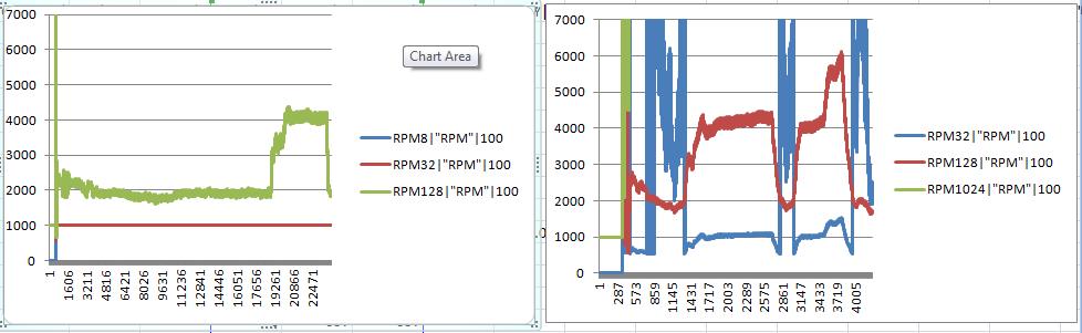

Alex W wrote:I can't get it to read anything other than 2x the actual speed. I initially set it up for 2 pulses per rev, saw that it was reading at 2x, so I changed it to 4 pulses per rev, but the reading is still double what it should be. How is that possible?
I made some tests to see which Clock Divider was best for my application. It looks like Clock/128 is best for the distributor rpm signal on an '87 VW GTI 16V, the blue square pulse in the screenshot above.
But now I have the same problem as Alex W. I had originally set the divider to 2 and the log showed rpm numbers double what they should have been so I changed the per revolution to 4, but the rpm numbers are still double. :(
Anyone else have this problem, and if so, how did you solve it?
I believe this probably needs to be fixed in the firmware. Let me check over the weekend.
Are you getting a stable RPM reading with the source you have now?
GTIspirit
Posts: 249
Location: SE Michigan
Post by GTIspirit »
brentp wrote:I believe this probably needs to be fixed in the firmware. Let me check over the weekend.
Here's what the test with the different clock divider settings looks like, just off by a factor of 2..... Looks pretty stable to me, I'm generally happy with the results now. :)
Clock/128 is clearly the best for my application. Four vane distributor with hall effect sensor on a 4-cylinder engine.
My only suggestion would be to implement a user adjustable PT1 filter on the RPM signal to filter out the irregularities, such as when starting and blips when the signal goes wonky for a moment.
Oh, and I couldn't figure out how to adjust the scaling or "time" err, sample axis in Race Analyzer, hence the Excel plots.
